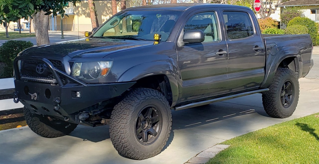

    I’m thinking of adding a set of ditch lights and wondering if I should go amber or white. Looking at BajaDesigns Squadron Pro’s. Looking for advise/opinions. Also, what is the cleanest bracket out there for the 2nd gens? I already have the BajaDesign fogs in amber.

    2017 TRD Sport 1D6

    Amber for me, squadron sports with a combo pattern. Mine are mounted behind my grill so lower than normal. I have them aimed out about 30 degrees to the sides with the driver side pointed a little lower than the passenger so as to be less obnoxious to traffic if I forget to turn them off. Have spotted lots of deer and probably saved some guys life this past summer. He decided it was a good idea to ride on a highway cloverleaf at 3 a.m. with no reflectors or flasher. Long story short, love them.
