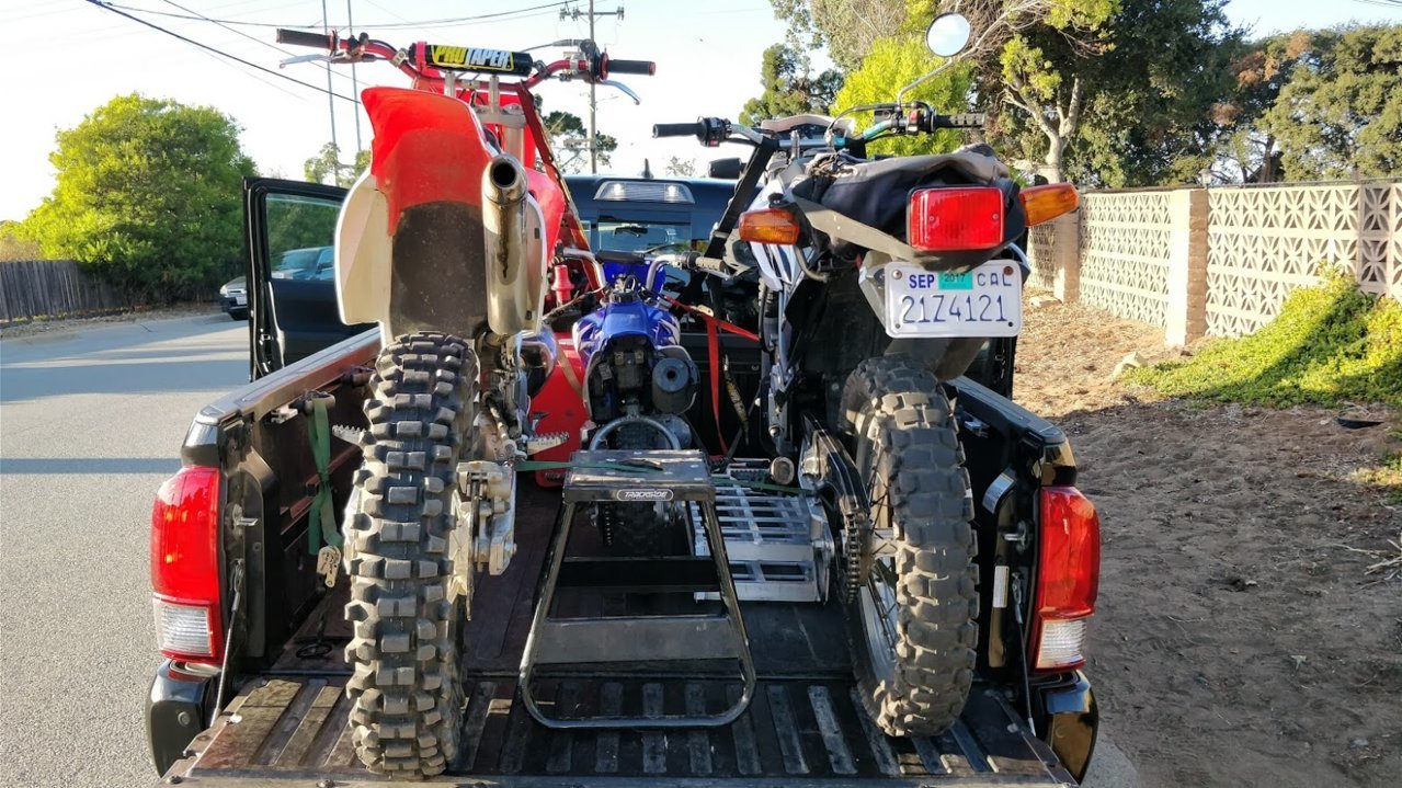

    Finally something I can contribute/comment on! Two dirt bikes is fine, totally enough rooms. Honestly you can get three if you are tricky with it (see picture) this is a long bed, but you will be fine just not a lot of room
