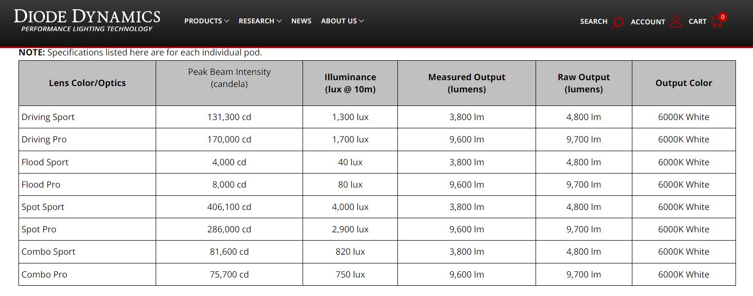

    So I am liking the output of my ss5 pods after testing, and trying to dig in a little deeper on the specs of them. Went on DD's website and grabbed this chart.
    I am looking at the Spot and Combo candelas and lux, does that seem right that the sport in both spot and combo have much higher candela and lux than the pros? and if that is the case, does that mean it is more effective to go with sport over pro if one uses either spot or combo pattern?
    maybe @Diode Dynamics can help clarify this? I am very confused after seeing this chart.
    Thank you!

    The sports use a phillips LumiLEDs chip, the Pros use a cree xpl-HI. The xpl-HI has a much larger die size. It can handle more power, and produce mkre total light, but for a given optic size, a smaller emitter is going to focus better.

    Got it, so basically for the spot and combo pattern, there is no point to spend the extra money on the pro models over the sport models? thank you for your response.

    Now that makes sense, however, a combo pattern is just one row of driving pattern with two rows of flood, so pro is more efficient in both driving and flood pattern, why would the combo (driving+flood) be the opposite? just trying to make sense of it. Thank you!

    I'm not sure that the mixed pattern on the combo SS5 optic is the same as the driving light optic diffusing channels. One thing dound in the SS3 tests in the J581 driving light thread (top of this forum, pinned) were that the combo beam SS3 had a different number of diffuser bars, leading it to blend more gently with the flood lenses, it didn't have half the spot intensity of the driving light optic.
    Pro would be a much better choice for anyone interested in running the combo or flood lenses, as the pro model produces much more total light from the XPL-HI emitters than the sport model does with its smaller, lower output emitters. More light total means a higher intensity (further reaching) flood effect for the Pro model compared to the spot.
    I forget which poster, but again in the driving light thread, someone posted a beamshot with theirbPro SS5'snwith the spot lens, and they stated they made the decision to pair the Pro with the spot optic, as it results in a beam that is similar in width to the Sport with driving light lense, but higher intensity than the sport ss5 with driving light lens.
