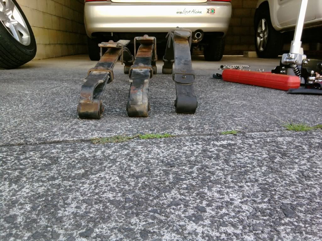

    no. They all have different rates, and the design of the leaf pack themselves are different. 5 lug base and XR are similar, as well as the 6 lug packs, but they differ from each other.
    2nd Gen Trucks come with one of four leaf packs.
    1. 5 Lug 3 leaf pack (greatest arch)
    2. 5 Lug 3 leaf pack (XR Models, De-arched, less capacity, stiffer, less progressive)
    3.6 Lug 3 leaf pack (different design than the 5 lug packs, the 2nd leaf extends almost around the front leaf hanger, unhappy overload vs. happy for 5 lug springs)
    4. 6 Lug 4 leaf pack TSB& Canadian
    6 lug and 5 lug leaf packs do however use the same mounting points so in theory they are interchangeable. 6 lug leaf packs do have less of an arch, so if you use them in a SUA setup on your 5 lug, they will drop the truck. I have this setup.
    6 lug leafs are a bit more progressive than the 5 lug leafs, and are stiffer. Speaking from experience.
    6 lug leafs on the left, 5 lug leaf on the right. the side facing you in the front of the leaf relative to the truck. notice the difference in the 2nd leaf.

    Old post I know but are you still around and do you have any before/after pics of how much the 6-lug leaf lowers a 5-lug? Would a shackle flip or some other mod restore it to stock ride height? What other consequences are there? It's pretty obvious that at least two of the leaves in the far left leaf pack are bent out of shape but is the middle one still more or less at stock arch?
    I have air bags now but with my cap and the base tool load I carry I'm having to keep a minimum of 30lbs to prevent bottoming. Ideally, I'd prefer to have the leaves deal with the base load with the 5lb recommended minimum bag pressure and use them primarily for leveling heavier loads. I obtained a 6 leaf set with 1.5" aals(1each) because of the more progressive nature but would rather admit ignorance and pass them along than head in a wrong direction. The choices seem to be either ditch these and get 5-lug specific aals or use them accepting either slightly lower ride height or doing some other mod to remedy that. I'm have no interest in raising or lowering for its own sake but if it is a minor consequence of acheiving a goal it's something I can live with.
