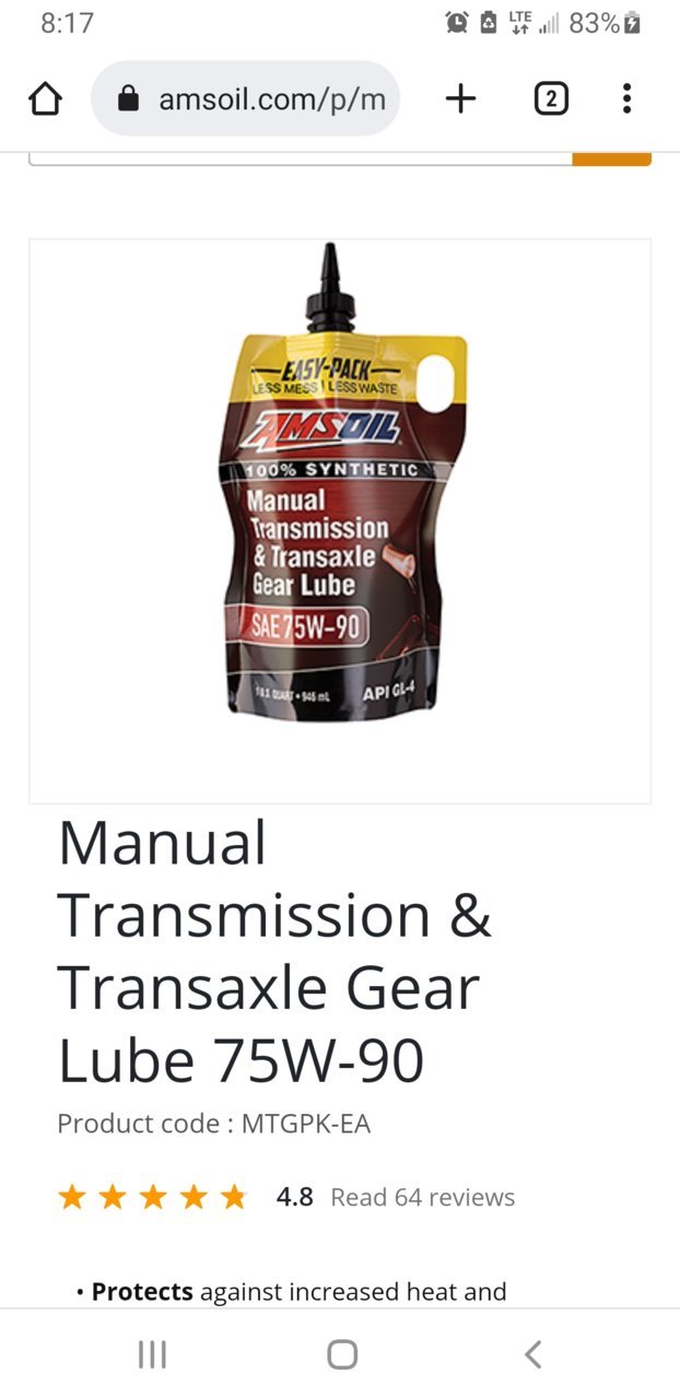

    AMS Oil has a GL-4 fluid that looks like it should work for the transfer case.

    That would be my choice from Amsoil, but it may not meet the "or equivalent" for warranty purposes.
