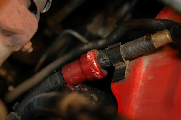

    It is very easy to over fill the front diff. If you fill it to the level of the fill plug threads there is a good chance it will puke some out the vent. 1/4" below the threads is plenty. Achieving just the right level can be a pain, and messy.
    As the oil expands with heat, little slugs of oil get forced out the tube along with bubbles of air.
    I put a catch can on the end of the vent hose so I can just fill the diff to the bottom of the fill hole.
    The can is just an in line fuel filter with the removable filter element removed. Red of course.

    No, this trick just allows bubbles of oil and air (IMO from over filling) to separate in the can. The air continues out the breather and the oil collects in the can and drains back into the diff when it cools. Filling is still done at the fill plug.
    That is what I use, for the last 230K.
