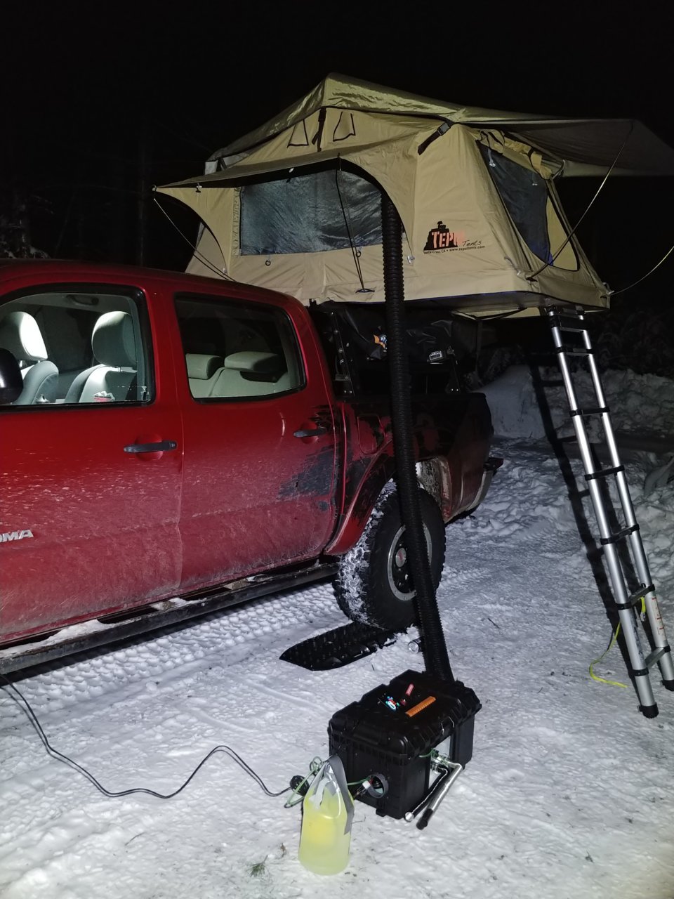

    Got it going last night! Had to run it through its cycle 4 times to get the fuel primed, but man this thing is so easy. Putting out good temps also. It’ll run on a set time of up to 720 minutes with a setting of up to 100 degrees. Currently 22 degrees out and it’s turning that air in to good heat. Guarantee that if I pulled the warmer air from the annex it would be a lot more efficient. Jackery 500 will be here sometime today, so in the meantime I started it up at 7am, hooked to the vehicle battery, to see how much power and fuel it will go through on a full 720 min run. I took a voltage reading from the battery before the run and I’ll take one after 12 hours. Just to see if I can run it off the vehicle battery if I absolutely needed to.
    I think I’m going to cut down the combustion intake tube to about 2-3” just so I can keep the debris cap on it. It doesn’t need the tube being mounted under the tent. The exhaust gets hot obviously, but an inch or two away, I can’t feel any real heat so I’m not worried about the fuel. In the self contained units the fuel tank is only a couple inches away from the heating unit anyways so I’m more than good with my set up. Used one of the Leitner light mounts for the muffler bracket. If I want to take the entire exhaust off, it’s just two quick release bolts on the bracket and the clamp on the hose. This rack makes so many things easy.
    Exhaust pipe on the end of the muffler will come off during travel, everything else will stay right where it is. Plenty of slack to open the box also. And… there’s enough room in the box for the hoses :cool:
    So far everything is working awesome!

    I like what you have going on. The only thing I might suggest is planning an extension for the exhaust to get it farther away from your sleeping area.

    Thanks. I’ve been thinking about ordering another full section to come off the muffler. Get it up higher. I was thinking about curving it down but depending on the wind it would just blow it towards the annex…

    5 1/2 hours in, battery has gone from 12.33 to 11.93. Here’s the fuel level, it was just under the sipped area below the handle. It’s also on a slight angle. Not bad so far
