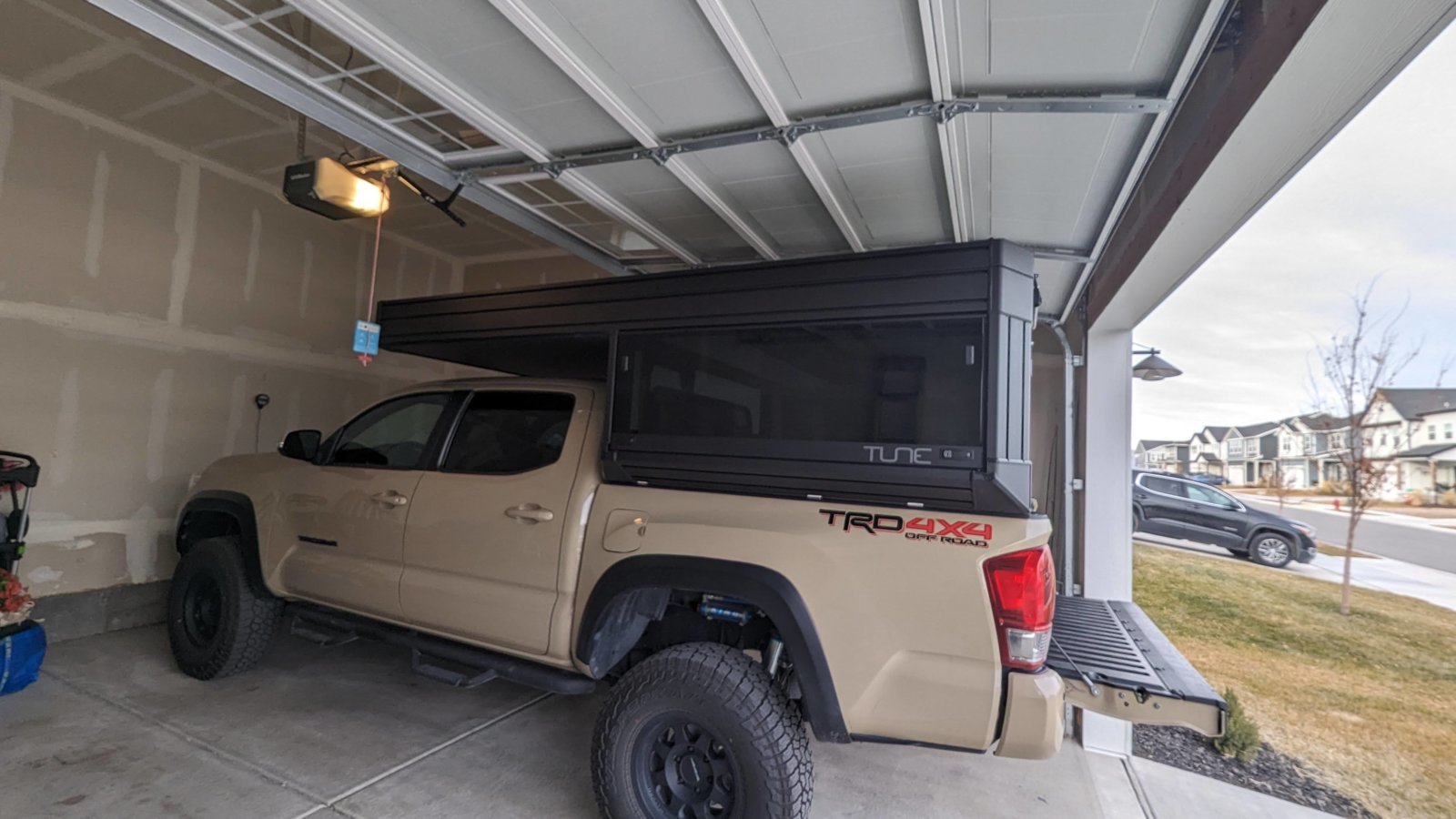

    What camper is that ? Link

  11. Dec 26, 2023 at 6:28 PM

  13. Jan 11, 2024 at 12:23 PM
    medicfung
    medicfung Well-Known Member
    Nov 21, 2018
    #273365
    1,027
    richie
    2019 DC TRD OFFROAD 4x4 6ft bed quicksand
    Man i love that M1 camper, i have a gfc but this has me wanting more
  14. Jan 11, 2024 at 12:53 PM
    redrockutaco
    redrockutaco [OP] Member
    Oct 29, 2023
    #436450
    17
    2017 OR
    Thanks! I really like it alot, having the short bed it really maximizes the space because it flares out instead of in.
    medicfung[QUOTED] likes this.
  15. Jan 11, 2024 at 1:59 PM
    medicfung
    Nov 21, 2018
    #273365
    1,027
    richie
    Im thinking of selling my gfc and buying a full pop up, i like the FWC project M but when i saw runnin4tacos video on the M1 i was a little envious, this thing is nice.
