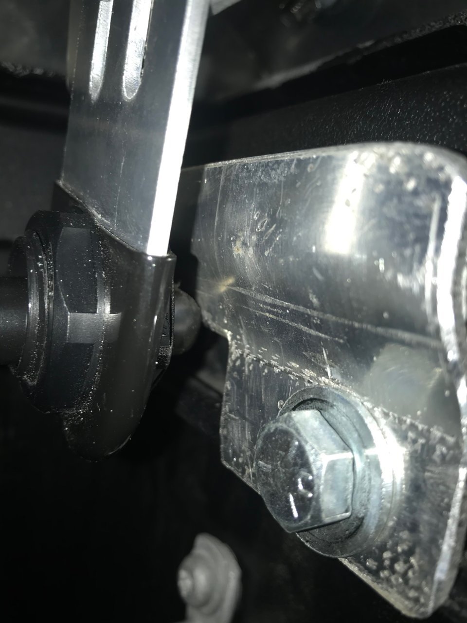

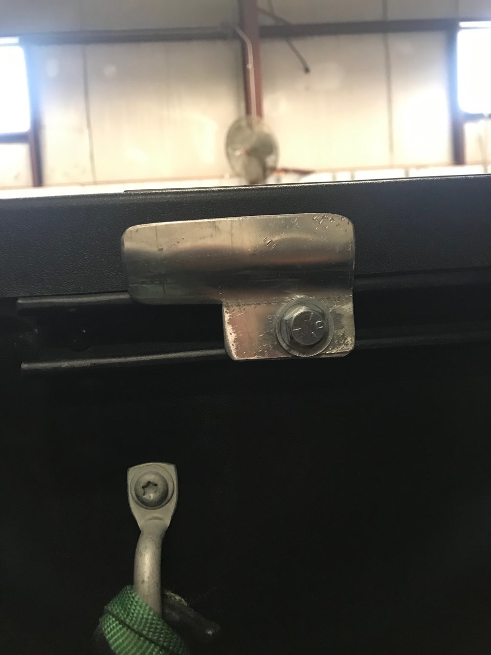

    I have always had issue with mine front panel not locking down with out having someone on the passenger side push down on it. It was set up with 280lbs on the panel, didn't open the front for 2 weeks. The panel would either not lock down(could feel the rod flexing) or if I adjusted the tension, the lid wouldn't compress enough to be water/dust tight. So I made a bracket do attach the the rail on the passenger side on the front. Now when I rotate the lock I can see the lid lock tight (moves about 3/4 of an inch).
    When I talked to Diamondback about the issue, they said it was possible that the panel could have been warped due to the heat of applying the line-x coating. They recommended I could "twist" the panel to make it lower on the passenger side.

    Diamondback also recommended this "twist" thing to me. I was skeptical and thought I was going to have to really tweak it to see anything, but with some gentle pressure (driver's side held up me pulling down on passenger side) it worked. I was shocked at how well this went. Now, from the driver's side, the passenger side clearly makes contact first and compresses when I press down from the drive's side.
