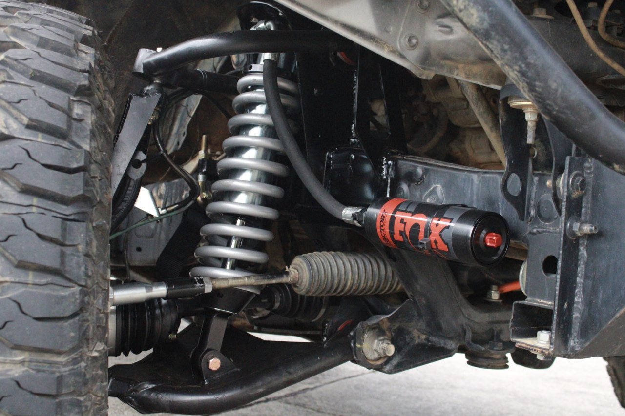

    Heres everything layed out when it showed up.
    Upon first inspection everything seemed well made and solid. Arms where heavy and welds look good but not the prettiest Ive ever seen.
    I used the DK spec fox coil overs and Currie (allpro) long travel axle shafts. Also the crown extended brake lines from DK.
    Heres everything installed.
    [​IMG][​IMG]

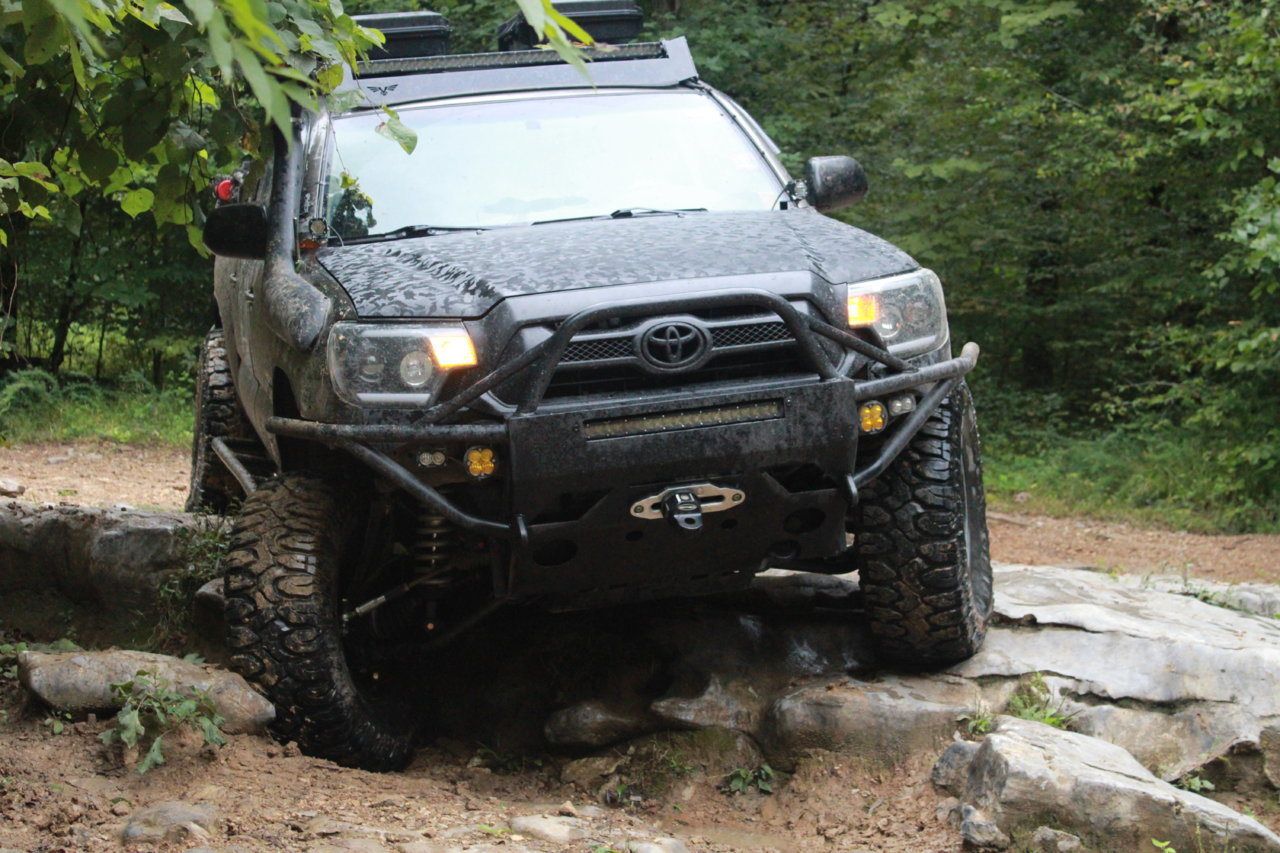

    The initial run was good got me the extra flex i was looking for but found i needed to trim down my bumps a little more.

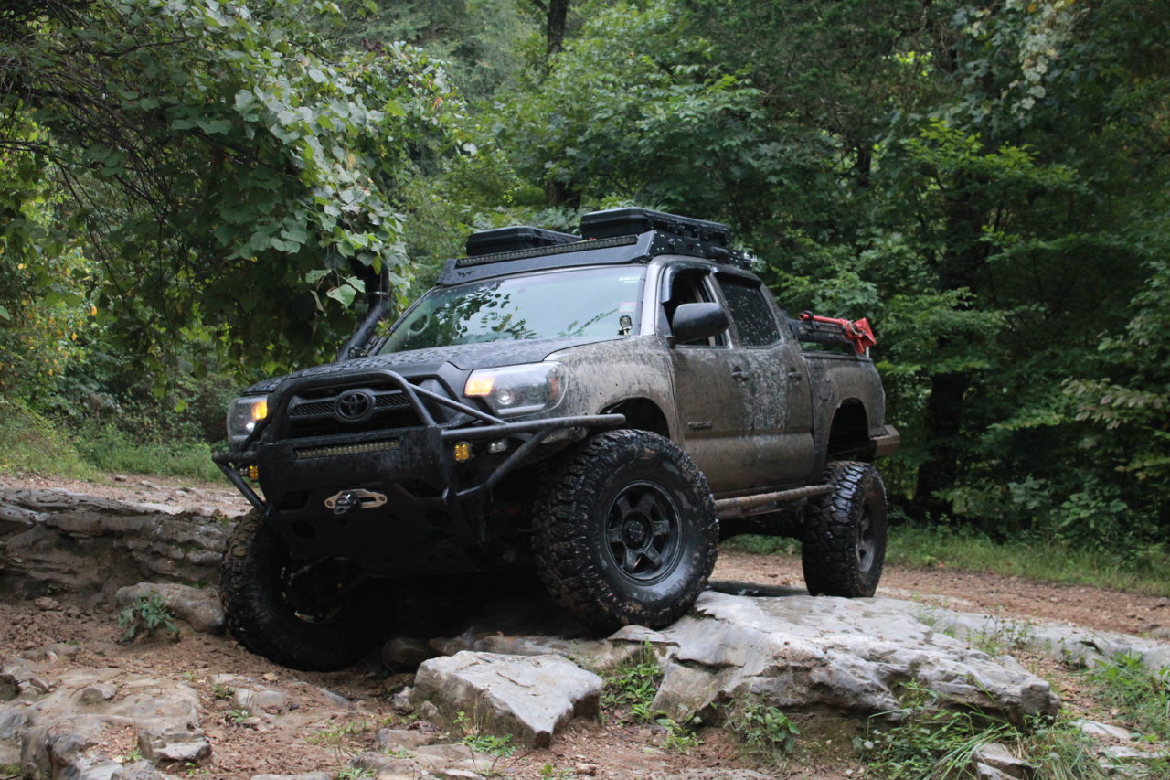

    This past Labor day weekend i was able to really test the suspension how i wanted to. I Ran a pretty tuff trail in very sloppy conditions harder than i normally do to really test the toughness this kit claims.
    [​IMG][​IMG]

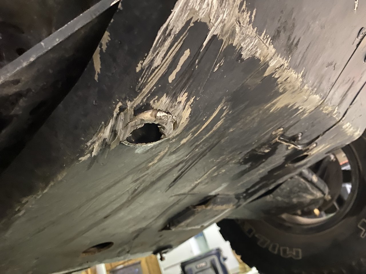

    The whole trail was rough but here are a few extremely hard hit that i got on the control arms. Broke my RCI skid and bent my MC frame brace
    https://youtu.be/Q3z-Au_402w
    [​IMG][​IMG]
    https://youtu.be/imYvfOdT3zg
    https://www.youtube.com/watch?v=4T06zKg2BTg
    https://www.youtube.com/watch?v=Oj7vfsbrIjY
    The lca had 0 dents and just had some of powder coat missing. I can say these arms are def chromoly like they claim and can take a hit as they took many all day long.
    My takeaways from this ride are that:
    1. This kit works as advertised
    2. The structural integrity did not fail after many large hits and skids on the arms.
    3. Kit increased wheel travel by 3.5 inches on my personal setup.

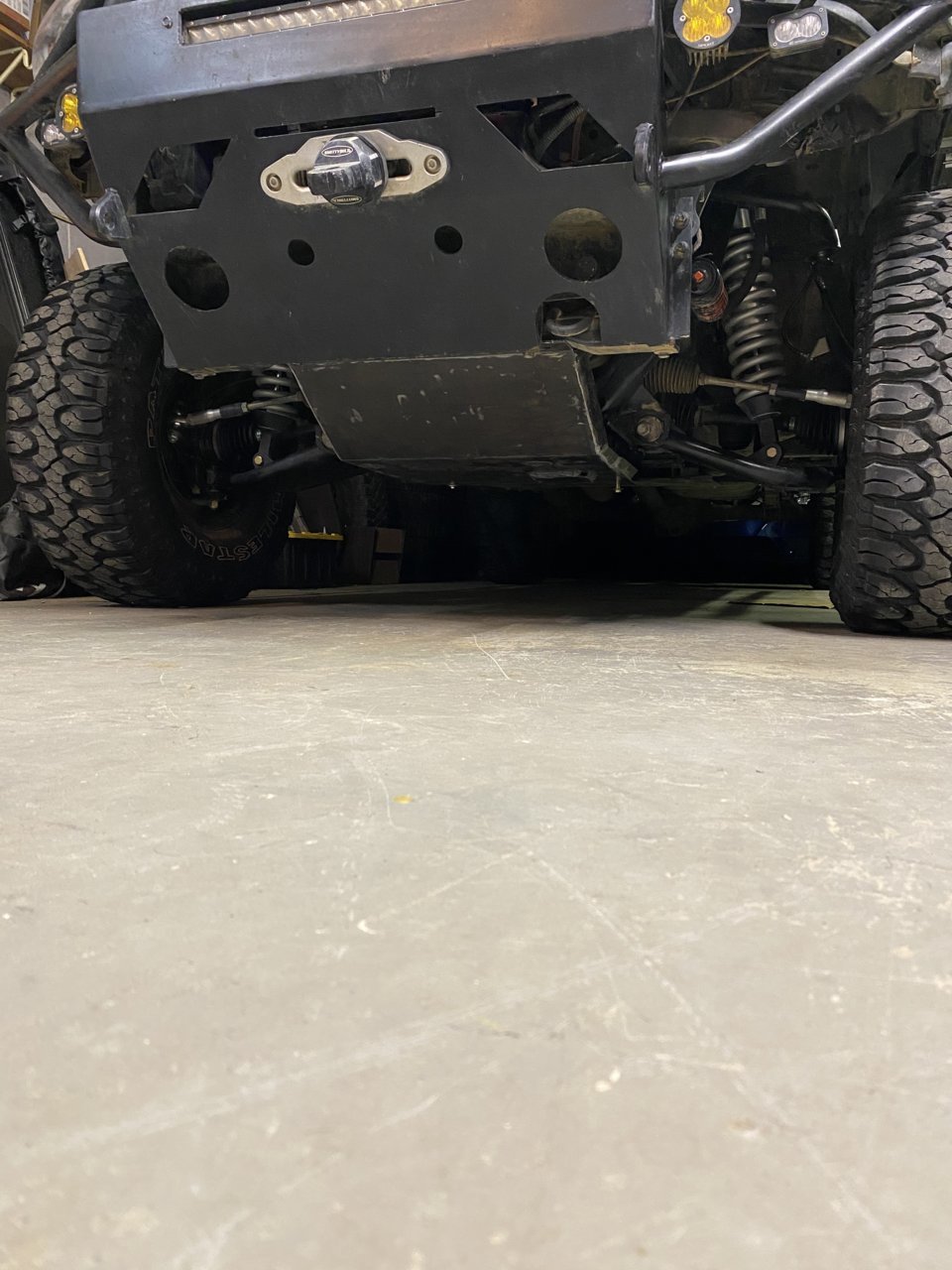

    Good shot of the ground clearance of the kit. I measured just over 11.5 inches from lowest part on LCA. Im on 315 75 16.

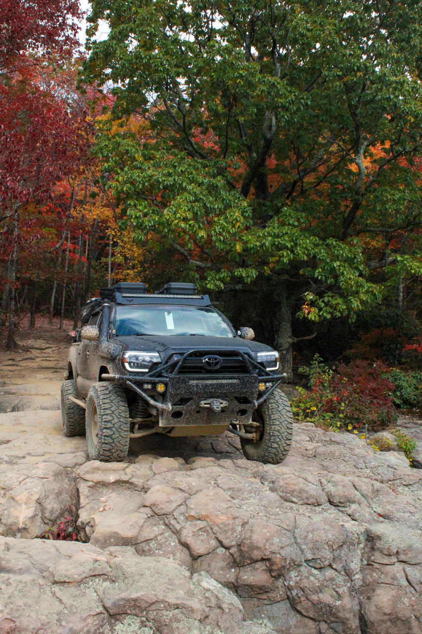

    Another trip in the books. Went to windrock park in TN. Did some pretty moderate wheeling (need driveshaft fixed and don't have spare +2 cv for anything crazy yet) Overall i was extremely happy with the way the truck road off road this weekend. Had a good bit of LCA hits that just chipped paint. So far so good. I will say my PC on one UCA arm is chipping already but not a big deal to me. Ill just paint over it. I put about another 700 miles on the kit and its going strong. So far ive put about 1500 miles on kit and its holding up just fine. About 100-150 being off road use. Here a pic and some vid of it in use. Unlike most ppl on TW i wont say something without context or proof to show for it.
