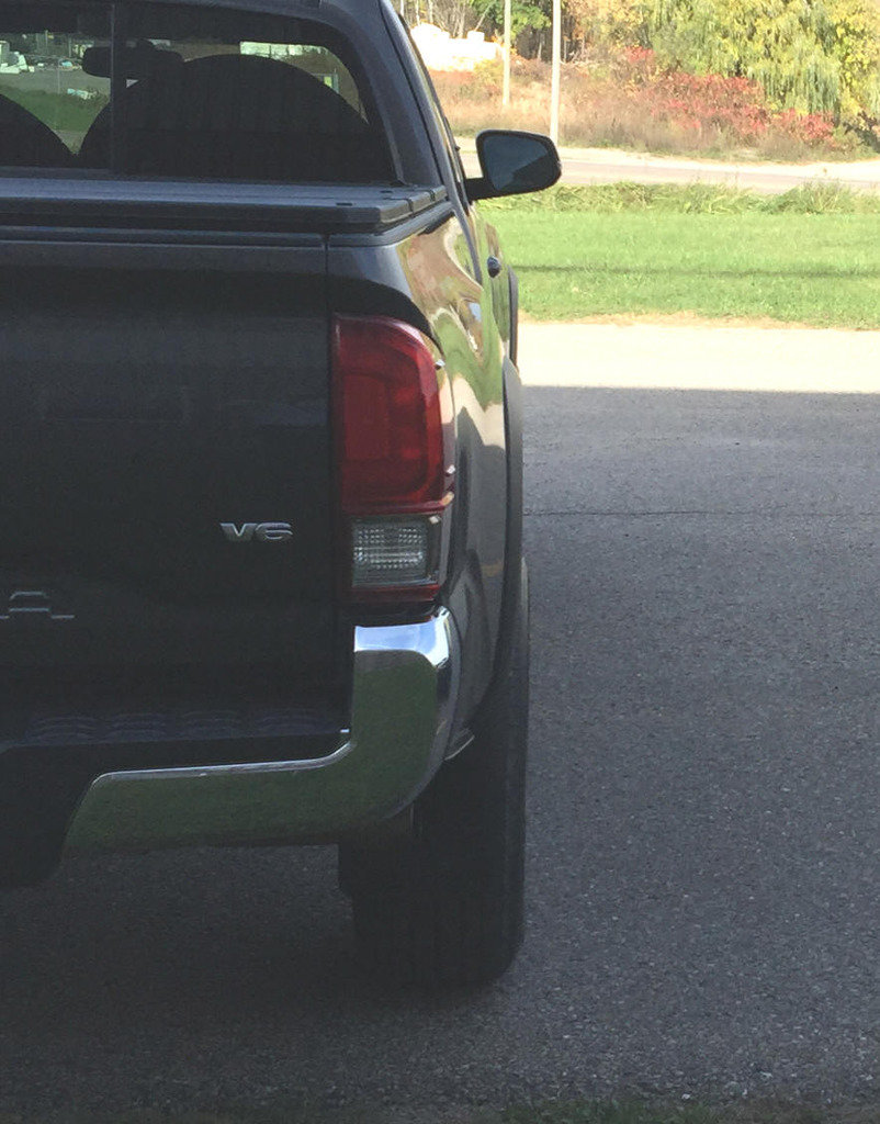

    As winter is just around the corner here in Central Ontario, I installed my Winter Wheels and Tires this past weekend. I've got a TRD Off Road and am using:
    Michelin X-Ice - 265/70/16
    Wheels are FAST HD Reactor's - 16x8, Offset +10
    Michelin Winter's run just as quiet as the Stock Goodyear AT's which is nice.
    Let it Snow!!
