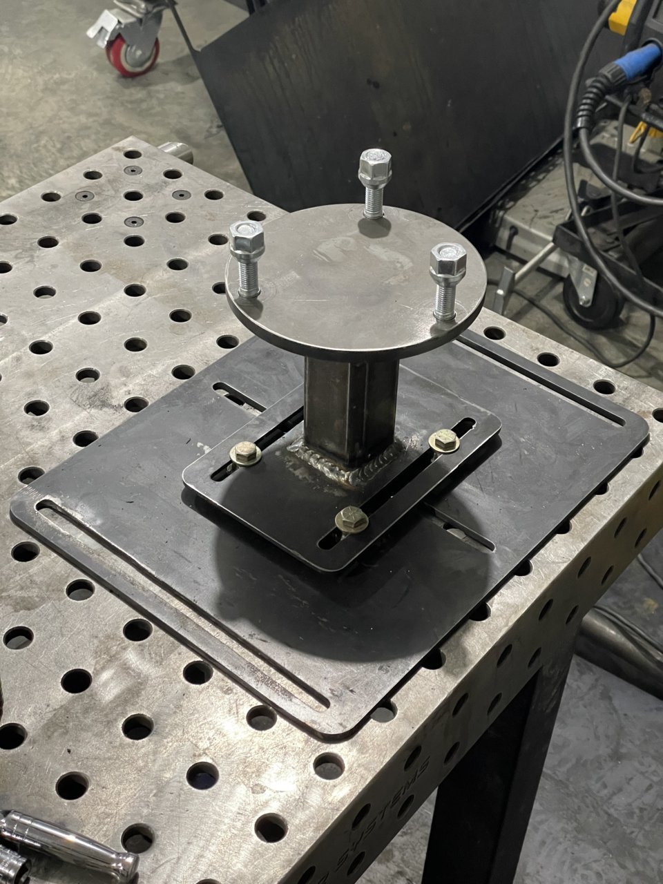

    I also have designed a solution for mounting your spare tire onto your Decked drawer system, and here is the first prototype. It is adjustable from any direction, and I am currently working on making it height adjustable for different back spaced wheels. Ideally, you want the tire to be sitting on the decked drawer with the spare tire being held snug by the lugs. That way it would not be stressing out the drawer system. This is not the final product! I have many things to work out as I install it and make it adjustable.
