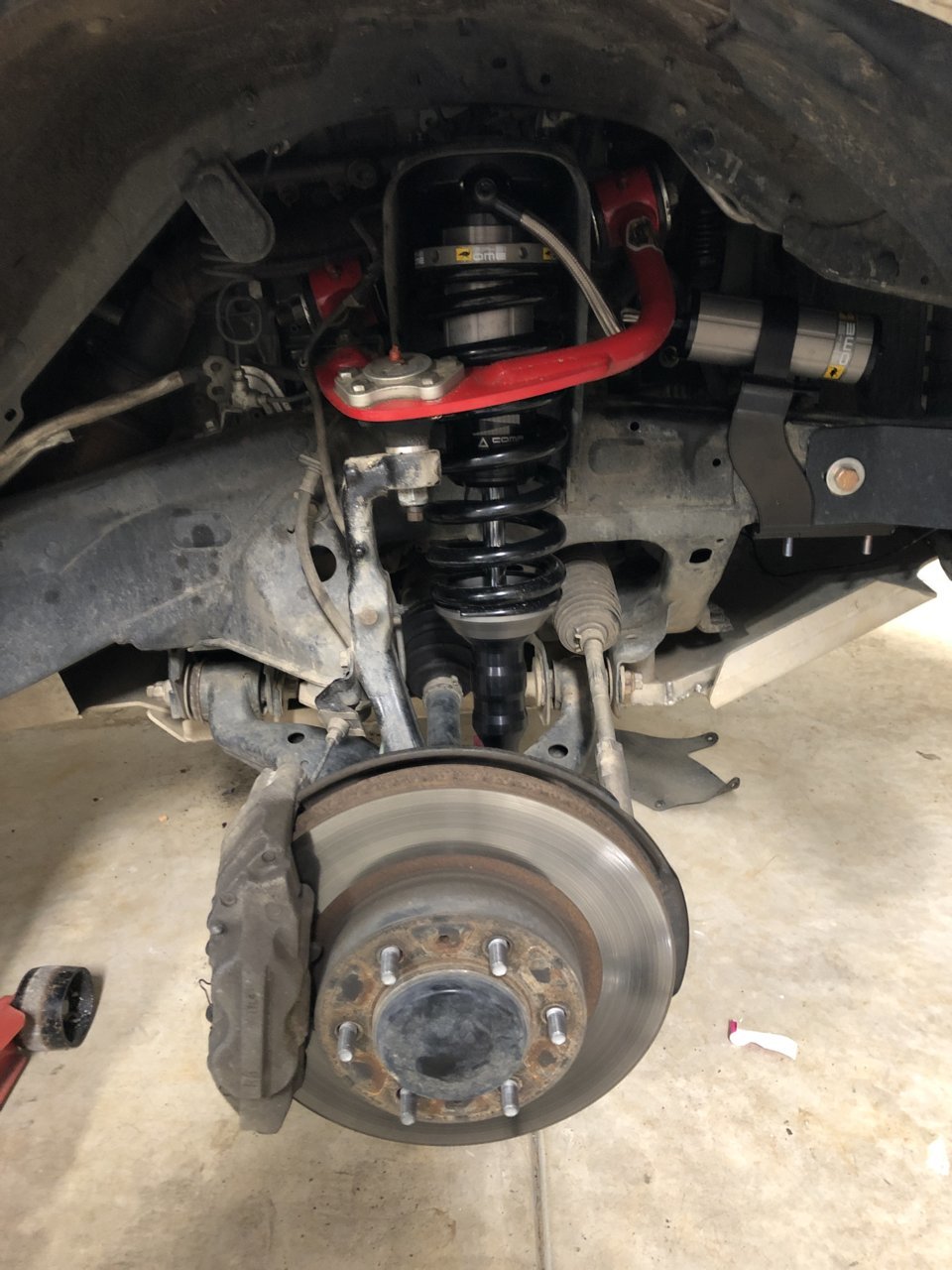

    Thanks! How high and how much?

    I think 2 maybe 2.5” is as high as you can lift and still get an alignment in spec without aftermarket UCA’s

    Adjustable, but I set mine at 2.5” in the front. I’ve been as high as 3” but start having problems with CV angles. You’ll be close to $4k for a set up like this, $5k if you can’t DIY.
