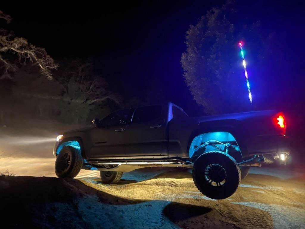

    Full droop, with 0 pressure in the airbags. I do have custom bumpstops, otherwise there would be 5psi min. pressure. The cradles seem to be doing their job. :thumbsup:
    doc76[OP] likes this.

    Great pictures thank you very much. Have you found any “clapping” noise resulting from the cradles smacking the bottom of the airbag assy?
    Love your custom bump stops BTW.
    What did you use for the rubber blocks?
