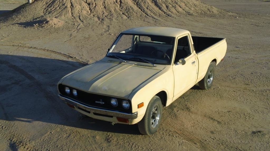

    Daisy is a 1974 Datsun 620 pickup. I bought her in August 2014 for $1300 with 90,000 miles on the original L18 4-cylinder with recently rebuilt 4-speed. The drivetrain was probably the best part of the truck though. The interior was a mess with bucket seats welded in by the previous owner. The wiring was a rats nest of disconnected wires and after a fuse box fire the previous owner disconnected everything that wasn't vital (including brake lights). The body had seen better days with evidence of body filler beneath the brushed on house paint. Being an Arizona truck, the only major rust was in the bottom of the doors where water had pooled due to the lack of window seals. Lastly, the brake master cylinder was leaking and needed replacing.
    Needless to say, this would be an undertaking but certainly a fun project! Follow along as I log the progress from this past year on my little Datsun pickup.

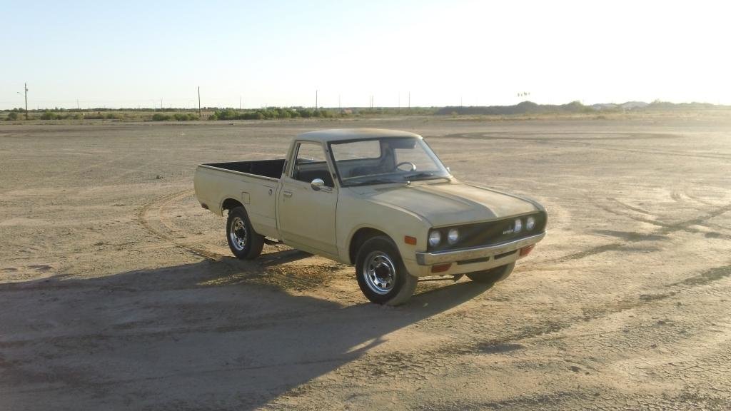

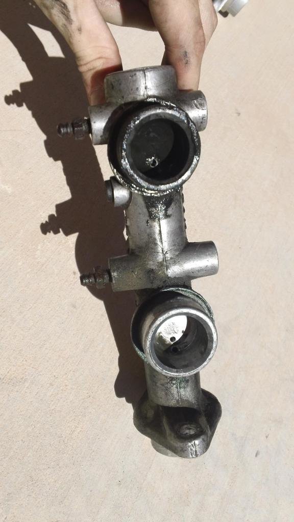

    Before starting on the fun stuff I had to go through and get the necessities out of the way. Most notably getting the wiring working and replacing the master cylinder.
    After the brakes worked and the brake lights lit up, I drove the truck around for a couple of weeks just getting to know one another. I learned a few things:
    • It's not a fast truck! Max speed is about 65 mph.
    • The gas tank is quite petite at only 8 gallons. There is a hole in the passenger bedside from where one of the previous owners installed a secondary tank in the bed.
    • A car without air conditioning in Phoenix, Arizona is pretty hot most of the year.
    • The bucket seats that are welded to floor don't leave much legroom and the old carpet was so dirty that it would create a cloud of dust in the cab whenever the windows were down.
    After I had more free time with school and the temperature dropped, I began tinkering and changing things.

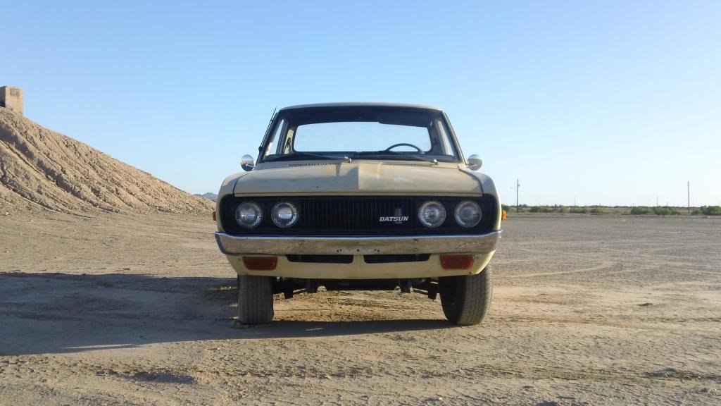

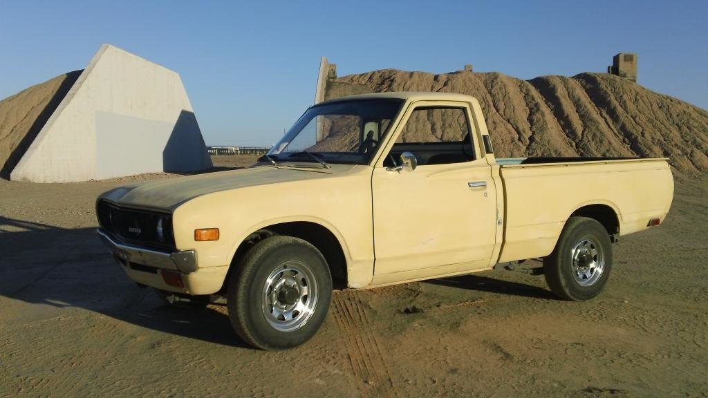

    The first order of business was bringing miss Daisy down to Earth by adjusting the torsion bars in front and installing lowering blocks in the rear.
    Before:
    After:

    For safety sake you should be running a steel block in the rear not aluminum.
  20. Jul 30, 2015 at 3:30 PM
    #20
    Tommy Tacoma
    Tommy Tacoma [OP] Well-Known Member
    Sep 14, 2010
    #43258
    207
    Mitch
    Phoenix AZ
    2000 PreRunner
    Full Old Man Emu suspension, Kenwood headunit and speakers, speaker grille deckplate mod, LED interior lighting, tinted windows, color matched bumpers and fender flares
    I didn't know they made them in steel, what does the material impact?
