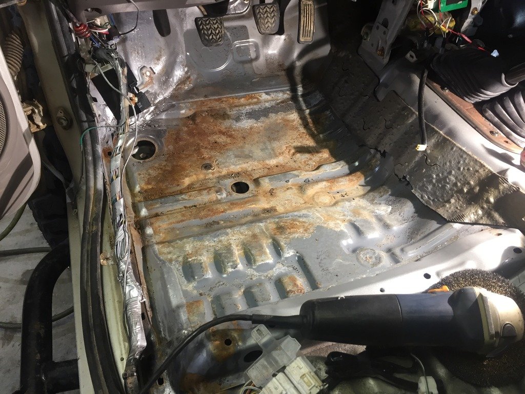

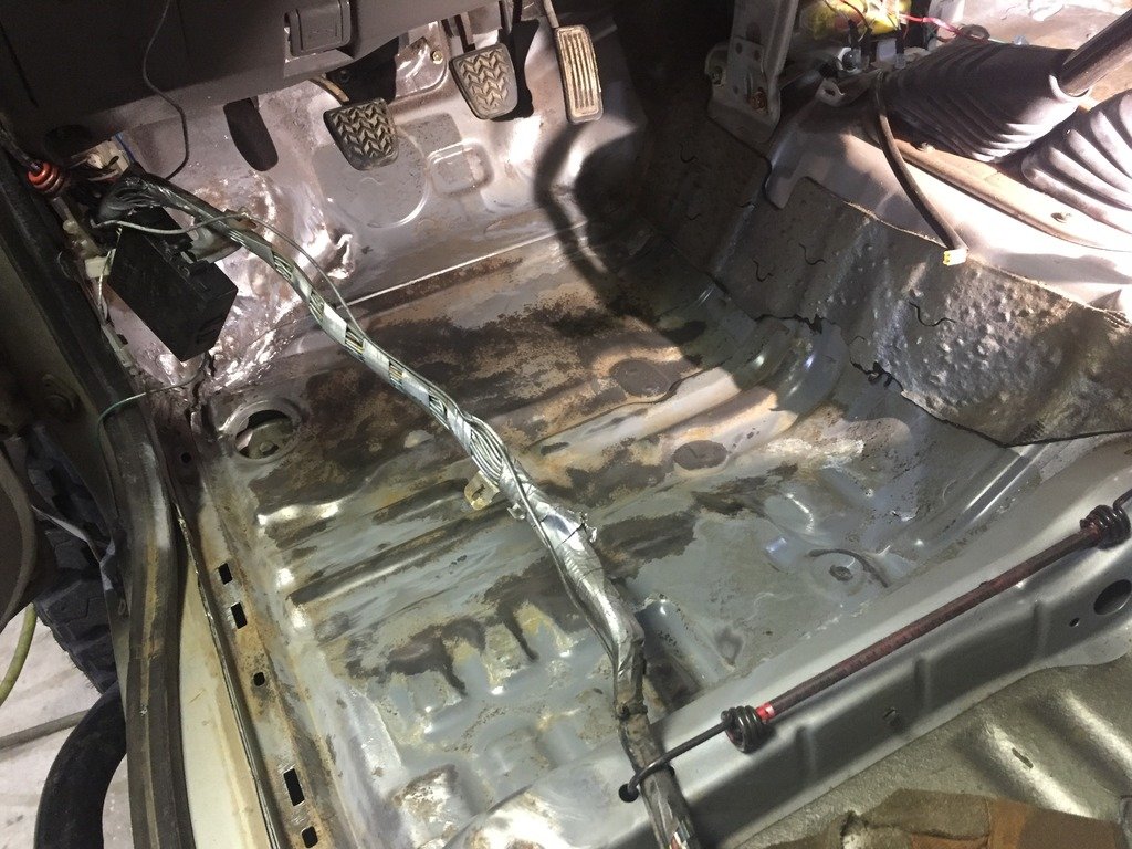

    As I was wire wheeling I realized the tunnel for the seat mount corner was compromised so I cut that out. I'll box/plate it to bring back strength. I pretty much got this whole section wire wheeled and cleaned up. As I was working on that I found the one section under my feet looked rough so now I need to dig into that. I also cut more of the tub out to make sure no more rust was hiding behind the metal.
    [​IMG]Untitled by Michael Halat, on Flickr
    I always had assumed that the water was getting in through the tub but I believe the door seals are probably more to blame based on the splash marks on the speaker and side of the dash.

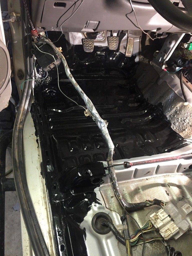

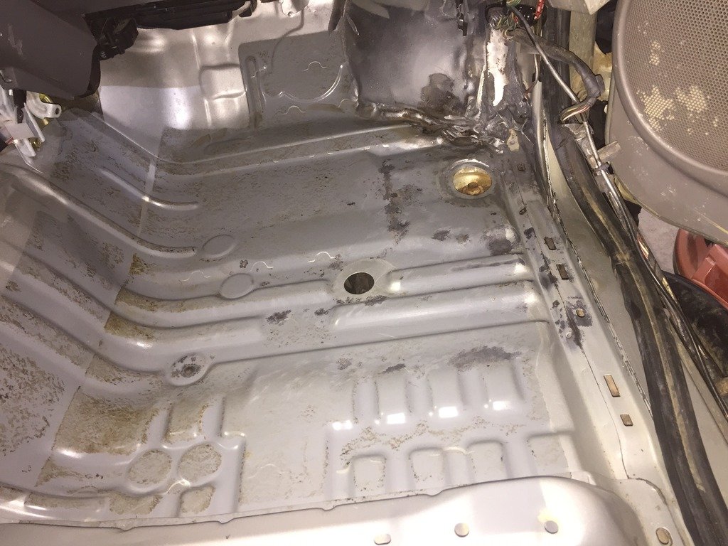

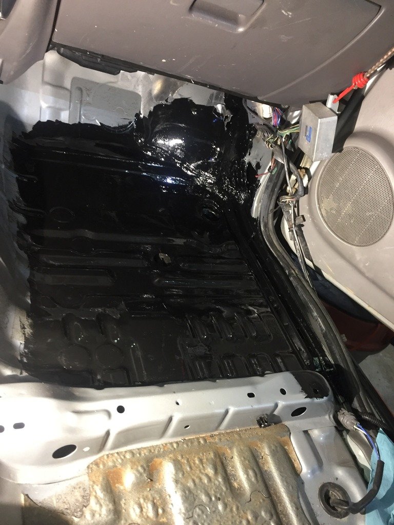

    Officially retubbed the firewall. Damn I loved using the 16 ga. It was a bit to form but was hell of a lot easier to weld on than the 20ga.
    Driver:
    Passenger:

    Things I am a fan of:
    Eastwoods version of POR-15 aka rust encapsolator. Super hard finish when dry.
    Eastwoods internal chassis coating. The 360* style spray made it easy to coat inside both rocker cavities.
    Eastwoods brushable seam sealer. Easily apply with an acid brush from a can, no caulk tubes to fuck with.
