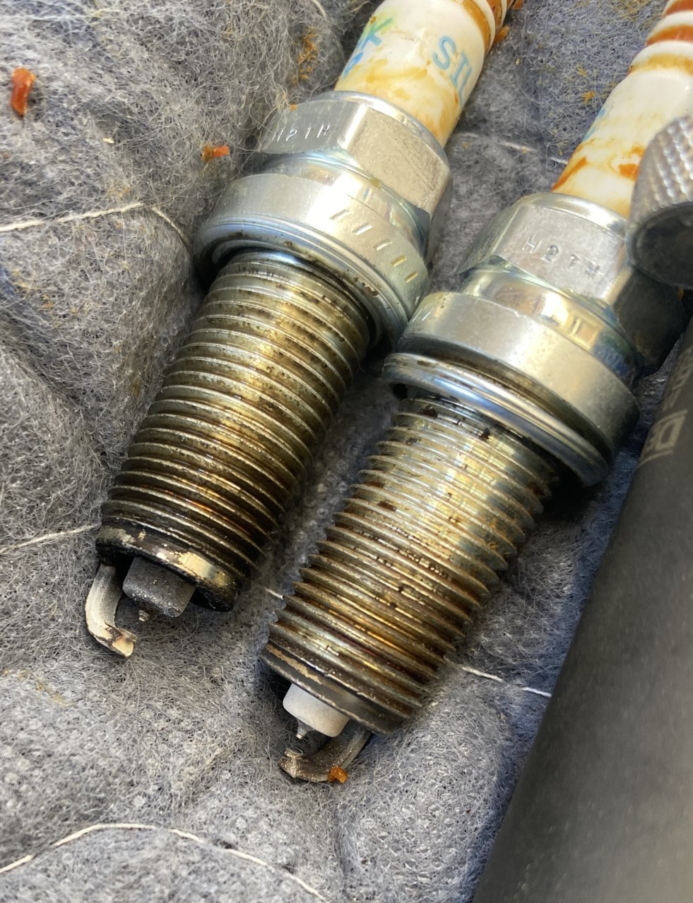

    I recently started getting a misfire from cylinder 2 from my 2005 Tacoma. Pulled out the old spark plugs and installed new coils and plugs. Still am getting the same misfire code from the scan tool. Also did a compression test on all cylinders, averaging 150-152 for each one. Thinking about switching out the old fuel injectors for new ones. Read around that it is possible that the old spark plug gaskets may be worn. Also attached an image of the old spark plugs (cylinder 2 misfire on left) Any helpful tips are appreciated!

    Those plugs look kinda oily, are your spark plug tube seals leaking?
    The 2.7L uses Iridium plugs.
    The 4.0L uses Copper plugs.

    If both plugs look leaky, wouldn't that mean that both of the respective cylinders are misfiring? or no?

    So I think you might want to check fuel pressure at that injector, but also I must ask, when did you last replace your valve cover gasket? Part of the gasket has the little o-rings that go around the spark plug holes....over time they can start to leak oil into the cylinders.

    Just based on what I'm seeing in that picture I think your getting oil on that plug.

    The crush gasket on the plug on the right hasn’t even been crushed?
    That’s not likely your problem, as the misfire stated before the “new” plugs.
    But I’d make sure the plugs are tight :confused:
