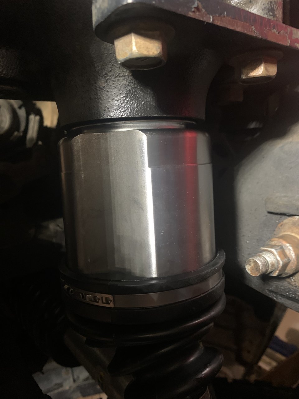

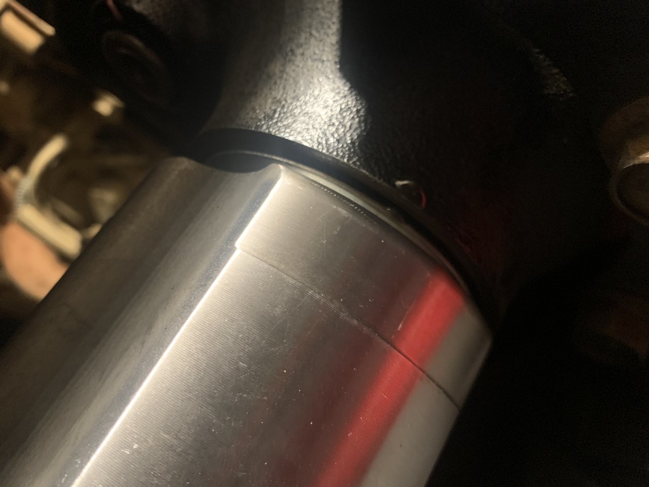

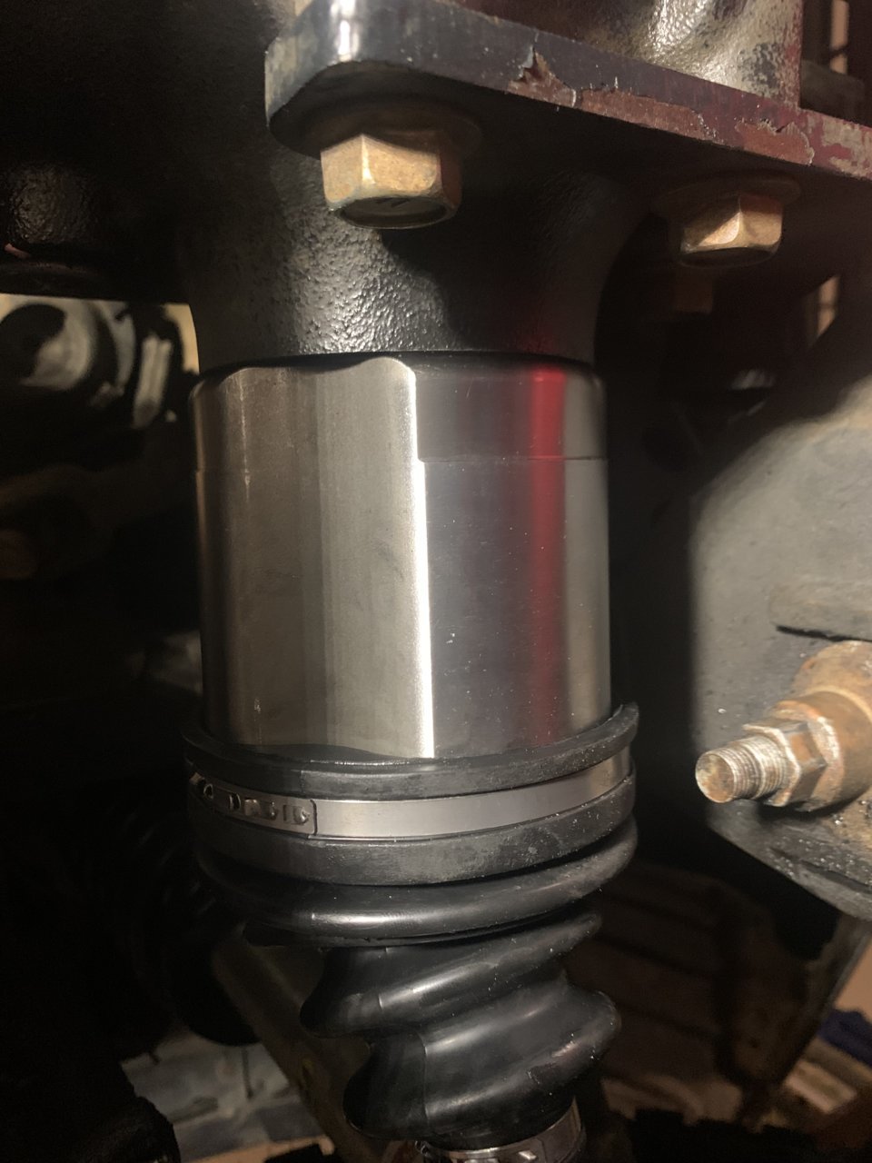

    Hello all, just changed my driver side CV axle this past weekend and noticed a slight drip. It appears that with the vehicle jacked up (nothing removed or anything) I can slide the CV slightly in and out, and when it is out the seal appears broken and it leaks.
    Also, when I was removing the original CV axle, I found this small metal ring on the floor, not sure if this is apart of the front diff or not?
    See pictures below for the described issue.
    EDIT: SOLVED, THE CV AXLE SEAL RETENTION SPRING POPPED OUT DURING THE OEM CV AXLE REMOVAL.
    Metal Ring:

    It’s normal for it to slide in and out.
    You can’t see the seal with the CV in.
    What you are seeing is basically just a dust shield. (The metal part)
    The seal is inside the the differential.

    I completely missed the metal “ring” the first time.
    That looks like the retention spring for the CV seal.
    With out the spring to help keep the seal tight to the CV shaft, it will leak.
    How big is the ring?
    The seal isn’t too hard to change. But you have to pull the CV “again”.

    You are lucky it fell outside the differential.
    You definitely don’t want it inside the differential.
    The spring faces towards the inside of the differential.
    You got lucky.
