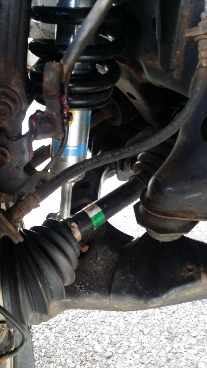

    My cv axles are binding pretty bad at full lock with my 2.5" lift. any way to fix this?

    Post some pics of your truck from the side as well as your suspension. They shouldn’t be binding with only 2.5 lift.

    Explain the bind and maybe take a pic

    Post a pic of these badly binding CVs.

    This ^ if they are binding,its from some other problem with your lift install.

    When are you experiencing this binding, and what does it feel like? Your pics look good to me.

    Looks fine, the wheels are turned. Only a problem if your doing 100s of reverse donuts.

    Your pics show normal cv angles with a lift. You're focused on the outer boot - the inner boot is the one that will blow out first (the joints themselves can handle this)
    I just replaced my passenger side axle 2 days ago due to the inner boot being completely worn through and separated from rubbing against itself because of my lift. Run it until it blows out, then run it until it frightens you. Then replace it with a CVJ axle with the high angle boot. Life is good!
    Edit to add: My truck has 135K hard miles on it and the axle I replaced was fine. The boot was torn for over 10K miles.

    its making a pretty loud clicking / banging noise when i turn either way at full lock

    is 4x4 on? did you trim your fenders at all? did you bend your brake dust shield during install, and just need to bend it back?

    nope its in 2wd. no need to trim my fenders . yeah I made sure the dust shields are not rubbing

    Is the tire hitting the skid plate? If the skid plate gets bent, the tire will hit it at full lock.

    I'm going to jack it up and try to spin the wheel by hand at full lock.

    Jack it up via the LCA to keep weight on it so it resembles ride height n spin the tire, then you can really figure out what it is.
