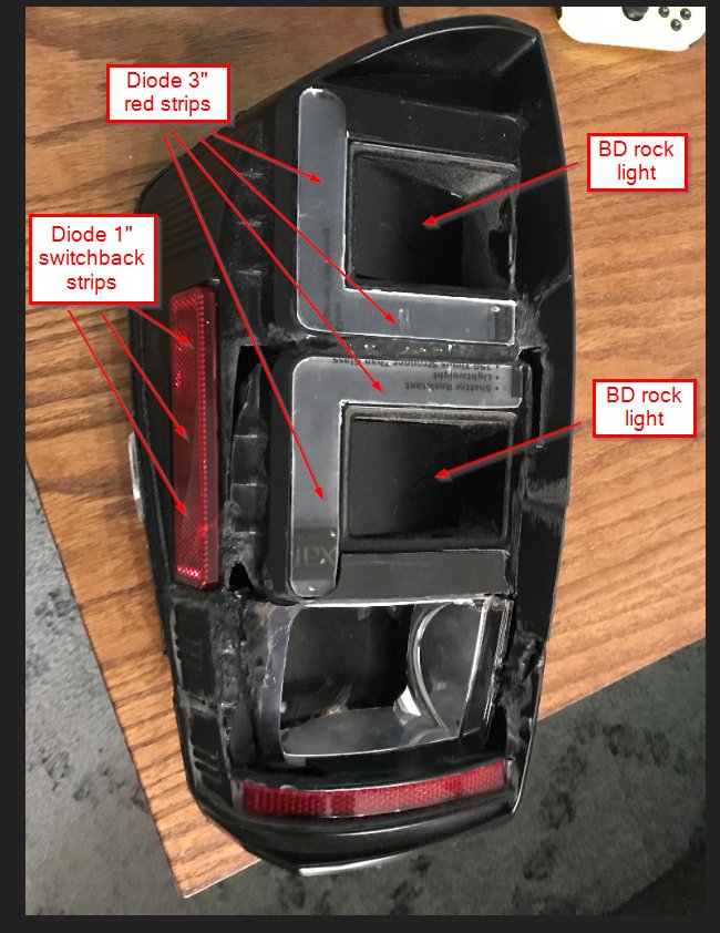

    Hey friends, I've been working on making some custom tail lights for a bit now and wanted to share progress for fun as well as to get some input and ideas from y'all along the way. It's been fun but, definitely a passion project cause they've been a pain in the ass before even getting to the wiring portion of it.
    I started out wanting to retrofit better components into some aftermarket lights from Spyder and make some tail lights that would better match the sweet Meso BD-4 3rd break lights I installed on my truck.
    After some considerations, I decided to customize the actual housings as well. I think the big white outlines for the running lights are pretty gaudy, so those will be replaced with some clear acrylic. I'm also modifying the design of them, I think the L shape will look good and a little similar to the stock DRL shape in the headlights. Plus it'll help cut down ever so slightly on the cost of the LEDs.
    The underpowered LEDs will all be replaced of course. The plan is to use Baja Designs red rock lights for brake lights, same as the Meso 3rd brake of course, and have the running lights/turns be Diode Dynamics red and amber LED strips. Side markers will be 1" DD switchback strips so they will be side markers and additional turns. Reverse will be white KC Cyclone rock lights mounted in the bottom bucket. Definitely not a cheap way to go about improving on these things, but they're going to be sweet.

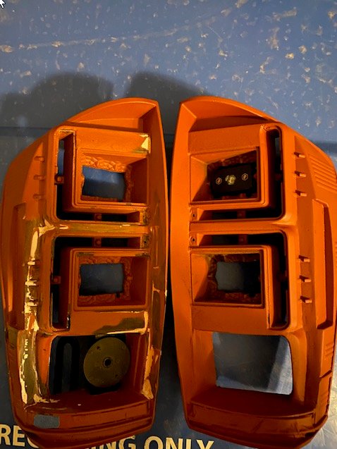

    Here's a super rough cut/test fit plastic welded together with LEDs mockup.
    And here's a little better filled in version with some primer.

    Some concerns -- I want to keep them street legal, so I'm a little worried that the rear reflector might be too small and could be missed. They'll be sealed with stock tail light lenses which have a bit of a distortion effect on the bottom of them. Might be necessary to add another reflector in there somewhere...not sure just where yet.
    Since the lenses going over the L shape for the running lights will be clear, I'm toying with the idea of having both red and yellow LED strips in there. I can't think of a good way to wire that up though so the red running lights will power off while the turn signal is active. If anyone has ideas let me hear them!

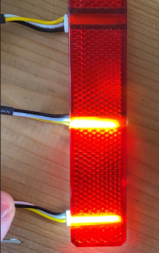

    Here are the side markers, milled out some slots with the router and sanded it down with the dremel so that the light would shine through. Gunna be running lights and then flash with the turns.
    Put the stripe outline on with some lens tint, makes the cut look cleaner imo.
    And testing out the 1" strips, they fit just right! Gunna look nice.

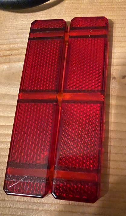

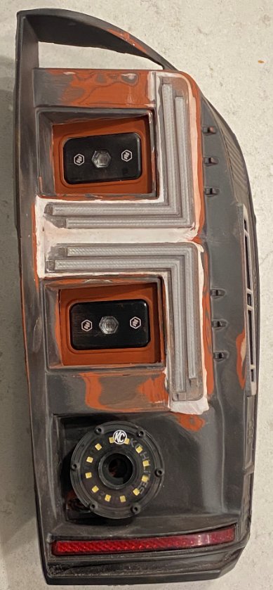

    Well with the quarantine I've had a little time to work on these a bit. Got most of the plastic work done, it's been a pain to get things looking smooth and uniform, a few bits bothering my OCD, but we're 95% of the way there.
    I decided to put the additional reflector on the top of the housing. I think it's probably the best looking spot for it, plus easy to get in there.
    I ordered some clear polycarbonate sheeting from Amazon that I'll cut for the L lenses. It's going to take like 3 weeks to get here though cause of their shipping priorities. No rush though except for my own impatience! These are getting close.

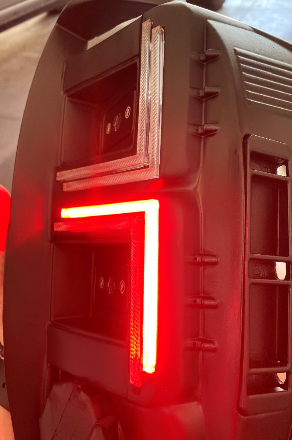

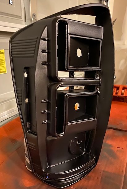

    Well it's been a while since last update, made quite a few revisions. Haven't really made this project a priority for a while, but I'm trying to get it polished off sometime this decade :facepalm:

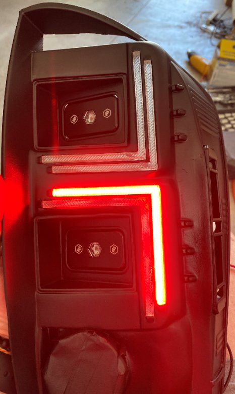

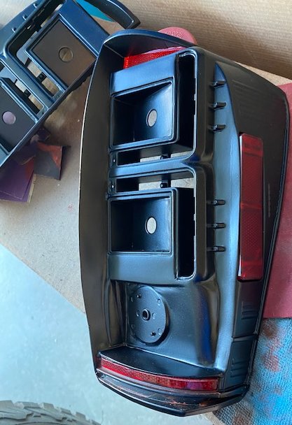

    1st thing, I learned how to design parts in Fusion360. So that opened up a lot of possibilities that I've been exploring -- namely designing and printing lenses for the LEDs rather than trying to mill out plexiglass which would have looked awful. So the designing spread to other parts, like baja designs mounts, side marker housing, and it'll just look so much cleaner and less homemade. I'm pumped!
    Reverse lights were going to be KC hilites, but I think they'll be super underpowered. So I'll be using the new Diode SSC2 LED Pods, which will fit perfect.
    Unleeeess....putting the BSMs in there would be feasible?
    I took the computers out tonight to get measurements and they'll fit with some modifications -- but I'm really wondering if it would even be worth it. The amount of work to MAYBE have them work correctly seems like a waste of effort and likely to end in failure. And that's not even taking into account figuring out how to make sure they're aimed right, stretch the wires without just...clipping them and soldering in extensions which I don't know if that will even work. Then the steel mounting plates are integrated into the computer housing so that's yet another hurdle with making them fit. That makes me nervous as well. I dunno, what are y'all's thoughts? Would be pretty awesome, and it'd make the functionality stick around for eventual rear steel bumper, but it's a shitload of things to figure out for it. I dunno, I hate adding in mods that remove functionality, ya know?
    Here are some pics!!
    rosswood and Tacospike like this.
