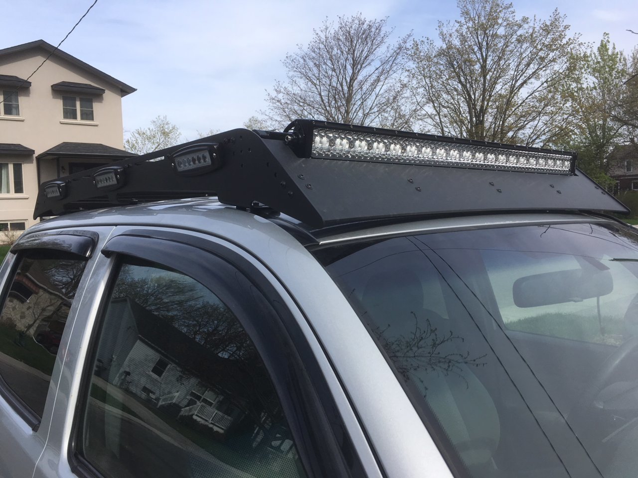

    I set out a few months ago to design a roof rack for my tacoma that better suits my needs. I had a specific idea/picture in my head of how I wanted it to look, and what I wanted it to do.

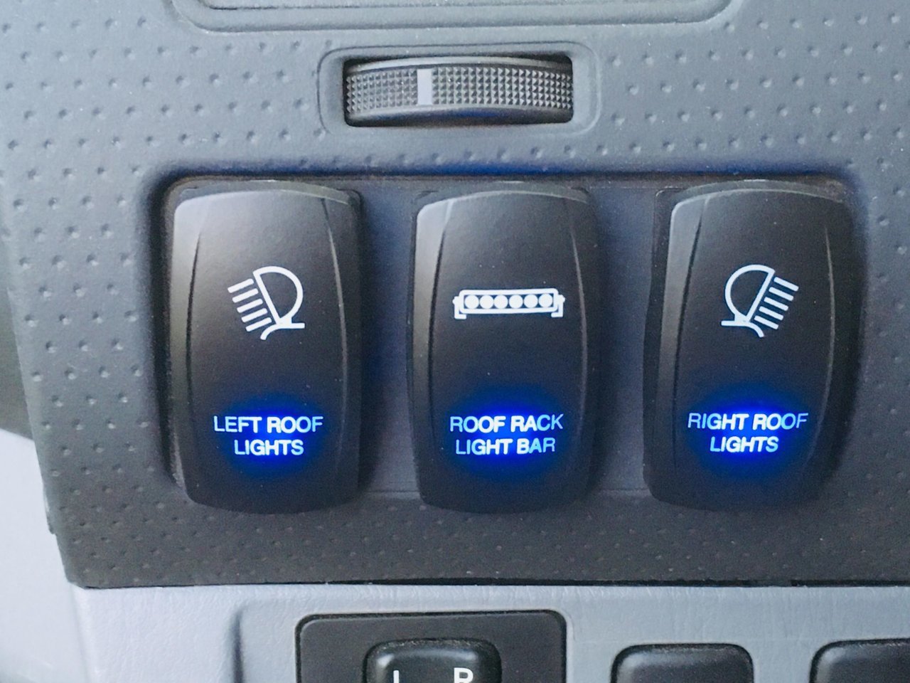

    The main thing I wanted was for my roof rack to be the 'hub' for all my lights. I wanted to have lights on the sides, back, and front (and I wanted all areas on separate switches. So that when I go camping I could turn on certain sections of the roof rack lighting depending on where I was set up around my truck.
    I have seen many people who hook 3 or 4" pod lights onto the T-slot of their Front Runner or Prinsu racks, but I never cared much for the look of it, and I use my truck as a DD, so having less stuff sticking off the roof to create less wind noise was a definite consideration. So I asked some friends on their opinions, and decided to create a roof rack frame with built in cut-outs for a very specific 7" lightbar that you can find on Amazon/Ebay for cheap. I bought six of these lights (3 per side), and mapped out the dimensions into AutoCAD onto the roof rack frame. I designed the frame to hug the roof's contours a bit better than other roof racks for tacomas, but also wanted to keep the "bolt together" simplicity of the rack, so I seperated the rack's frame into 4 different sections (Front Wind Guard, Left Rail, Right Rail, and Rear Guard).

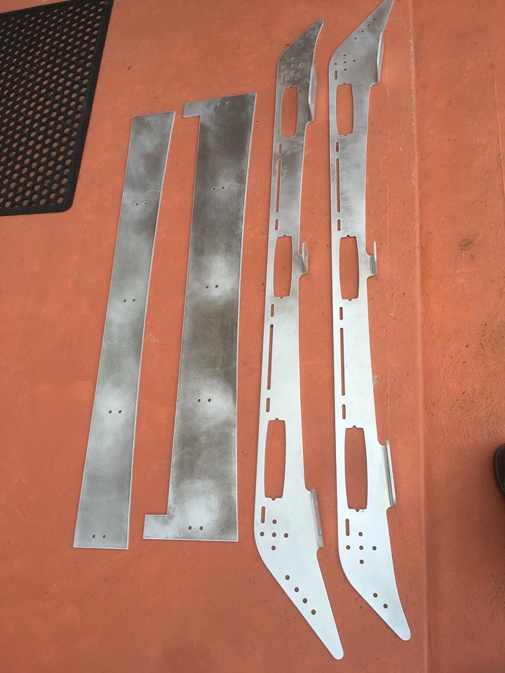

    I sent my design off to the laser cutter and had my first prototype finally made.
    I then lined up the newly purchased mini lightbars and they fit perfectly!

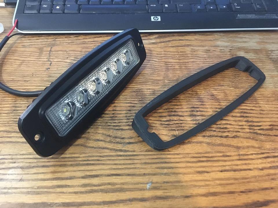

    Only one thing I didnt consider. The light will be shooting straight out from the roof, meaning the ground around me will not be lit up, only the trees to the sides of my truck. Flush mount light bars do not have the same flexibility to move around as pod lights. So I opened a 3D modelling program known as Blender and designed an angled spacer for the lights. The spacer is designed to sit between the light and the roof rack, and angles the light bar down around 15* (which is perfect and lights up the ground/rocks beautifully). I made six of these spacers out of ABS plastic on my 3D printer at home with the model I made.

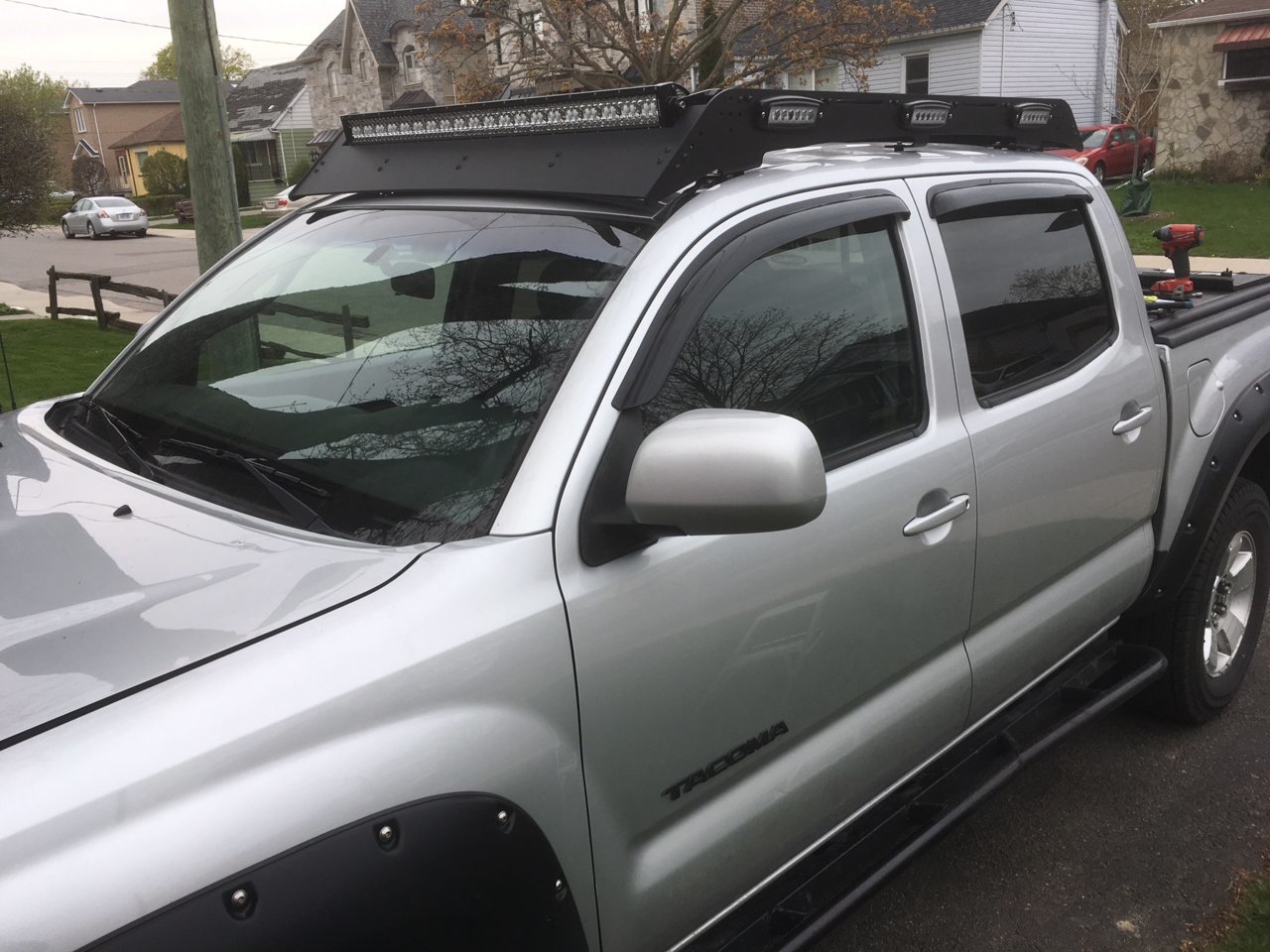

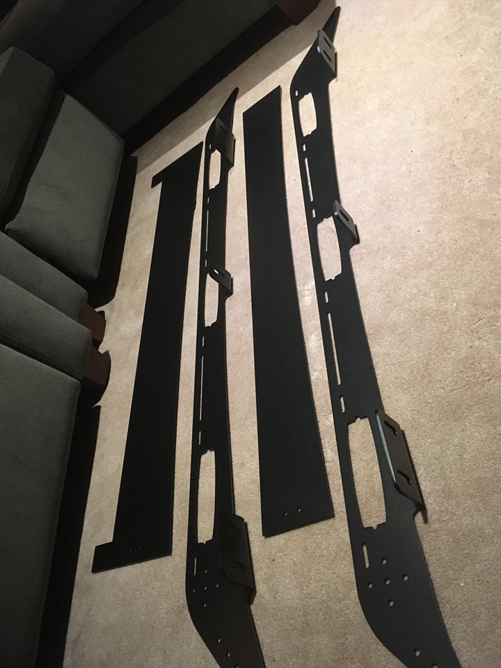

    After that, I sent my frame rails off to be powder coated and got them back pretty recently. I bolted the rack up and think it looks fantastic.
    I need to find a warm weekend soon here to run the wires to the roof and attach the flush mount light bars. I added an opening on the front wind guard of the rack as well to mount a larger 42" light bar. I havent picked out the light bar I want yet, so that is still to come.

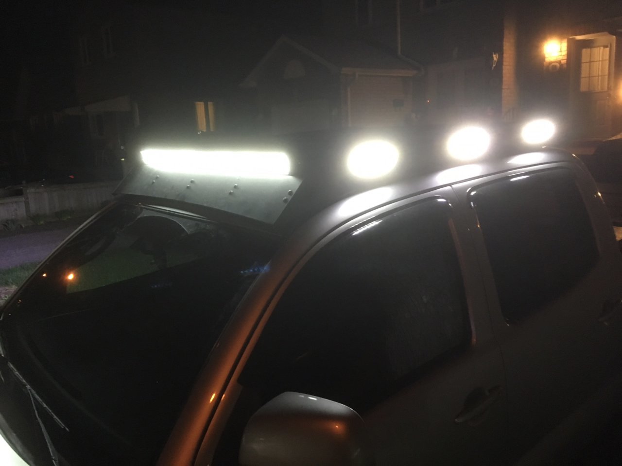

    So I got all my lighting hooked up! What a difference. I now have light from all angles

    DAMN! That rack is fire. Flows nicely with the contour of the truck. Nice job! :thumbsup:

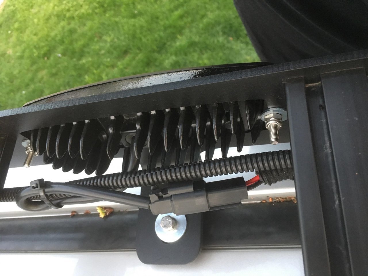

    Thanks man! yeah I modified the back a bit to flow with the lines of the truck more. And the 'wind' guard at the back doubles as a plate to hide all my wiring for my lights haha.

    very nice build, I love how the side plates follow the roof line.

    wow! nicely done! I love it when people freely share their designs, but i bet you could sell your design to a manufacturer. It looks slick. I wonder how much weight it could hold before the 90 degree bent brackets would need gusseting.
    Does the top of the front light bar sit under the crossbars so you could load a canoe, kayak, ladder, etc on top? or does your cross bars accept thule or yakima stuff?

    Yes, the top light bar sits under the cross bars. Honestly, my whole goal for this roof rack build was "As much light, as cheap as possible". The lights you see on the side were ordered on Amazon for $25 for two. And the front light bar was $70. Unfortunately, there weren't a whole lot of options for 40" lightbars under $100. If I was to choose a lightbar again, I would get a single row/skinny 40" instead of the double row I have now. A more expensive single row would sit a lot more comfortably under the cross bars to the point I wouldn't be worried about smashing it if I was loading a ladder or canoe on the roof.
    The rack is actually incredibly solid, you can shake the entire truck just by rocking the rack back and forth. I was standing on top of it without it flexing/showing any signs of stress. The aluminum used in this is high grade and for what its worth, was expensive vs doing the rack out of steel.

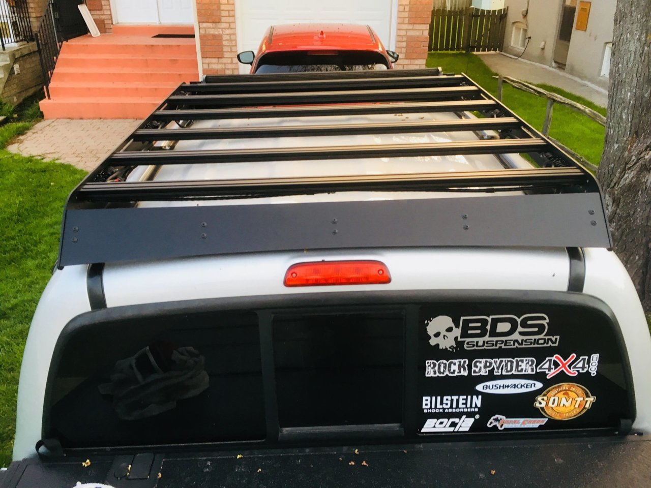

    One main thing im loving about this design, is the addition of the rear wind guard/wind plate. It makes the rack look nice from behind, but the best part is it hides all the wiring from the lights on the rack. You cannot see ANY wiring from the ground, just the lights themselves. Which is pretty awesome.
    You can also see from my last pic, how the lights I bought on Amazon (Which are sold as flush-mount lights), sit recessed into the frame of the roof rack via the laser cut holes/cutouts. They bolt in nice and easy and the wiring neatly tucks away behind it, out of sight.

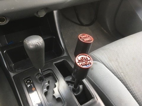

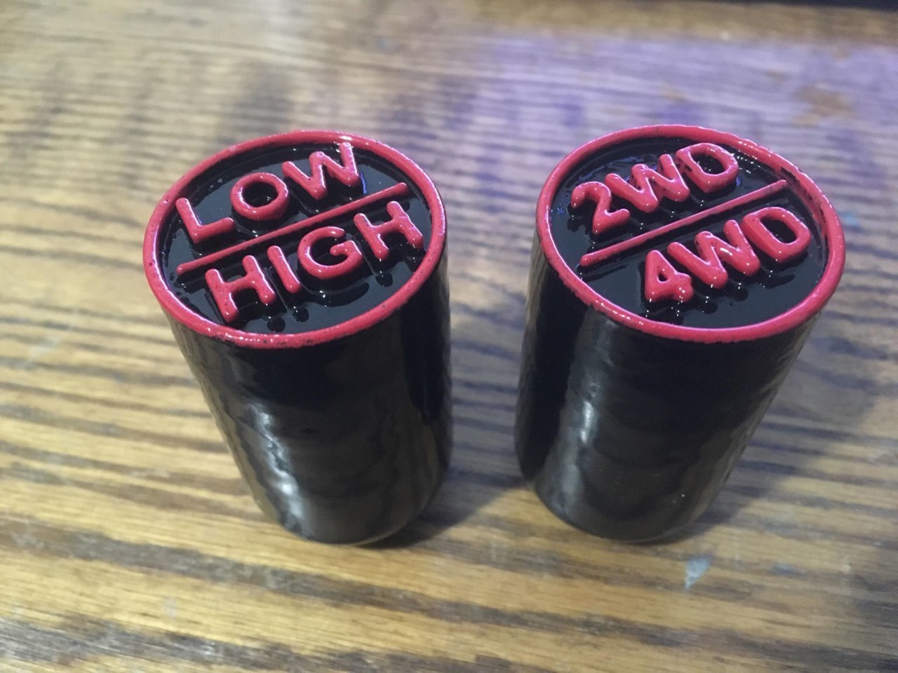

    I swapped the electronic 4x4 system in my Tacoma in place of a manual shifted 4x4 system for reliability and strength, and I made and painted (poor paint job though haha) these custom shifter knobs. The same thing would of been around $60 online, I made it at home with $0.75 worth of printer filament, and some red paint.
    Its a fun tool and amazing how I can turn something I just designed on the computer 2 minutes ago into something I can hold and use on a daily basis
