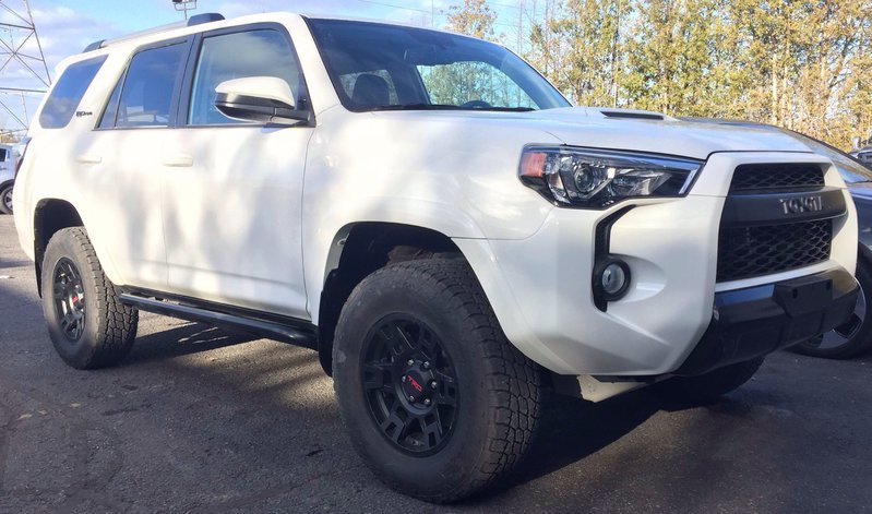

    Well...good news! I found a (perhaps the only*) 2015 4Runner TRD Pro in Canada at a used car dealer not far from where i live...and will be picking it up in a week!image.jpg
    (*4Runner TRD Pros were not sold in Canada in 2015 or 2016 - but will be in 2017)
