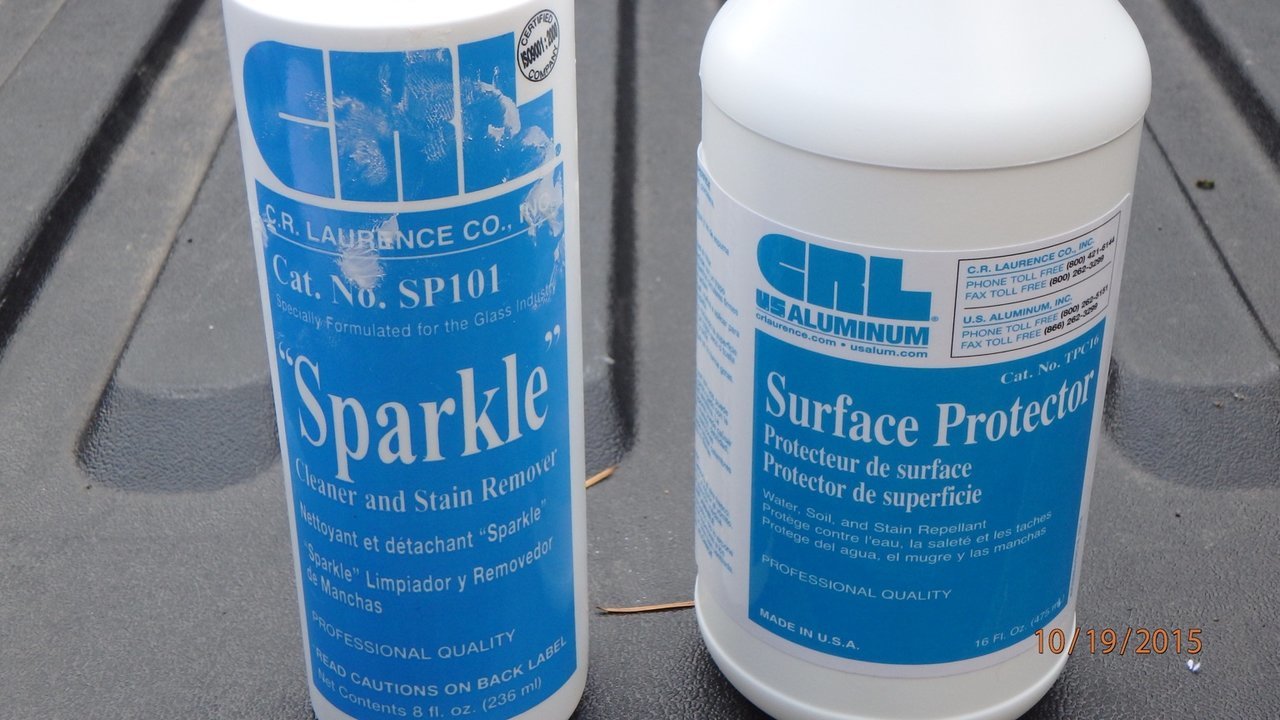

    Just about when I had given up with over the counter products and searching TW I came across a thread where CRL Sparkle, Bio- clean, and Surface Protector were talked about. I went ahead and ordered all 3 products off Amazon http://www.amazon.com/CRL-Sparkle-Cleaner-Stain-Remover/dp/B001G1APNE
    The difference between the Sparkle and Bio-clean is the Bio-Clean has a coarseness to it. It is recommended to be used on textured glass like some shower doors. The Sparkle is smooth and the Surface Protector is just an industrial strength Rain-x.
    Earlier this week I had some free time so I polished and waxed the truck and then tried the new products on the windows. I used a polishing pad to apply the cleaner and the microfibers to buff them out. I applied about a quarter size amount of sparkle to pad along with a couple table spoons of water. Then I just applied moderate pressure and worked the window over and then wiped the cleaner off. I recommend doing this when the temperature is cool or the product dries really fast. It was about 63° and in the shade when I applied it. I only needed to clean each window once except for spots that I missed that were user error and not product related. After all the windows were clean I applied 2 coats of the surface protector to each window as the directions stated to do. The Surface Protector is the rain-x.
    The whole process took me about 40 minutes but that was after polishing and waxing all afternoon. All the water spots are completely removed and I can't even describe how clear the widows are to look out of. It's like looking at a crystal clear T.V. If that makes sense. It rained about enough to get the truck wet this week. As I drove all the water that was on the windshield beaded up and scooted itself off the widow.
    If you have water spots or just want the cleanest glass possible I highly recommend these products over any other product that you can buy. This is the best. I will update the thread as the winter goes on to see how long the surface protector lasts.
    The Sparkle and Surface Protector
