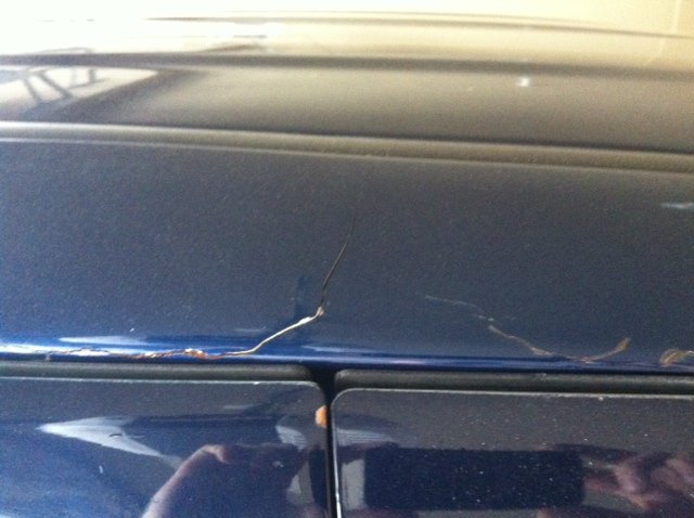

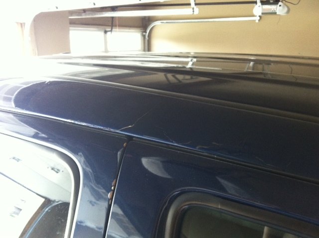

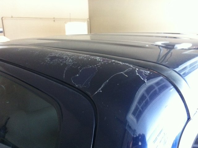

    Hi all,
    I bought a used 06 Tacoma TRD off road a few days ago, truck runs and drives beautifully and has low miles on it too. I got it cheaper than it would usually go for as the original owner had rolled the truck back in 08. Insurance paid to fix it, but now the repair job is showing its age... There is bondo cracking on both top pillars (Cant remember the name sorry) of the truck just before the main roof panel.
    Unless you’re looking closely at the truck, you can’t even see the cracks... and to be honest id be fine just leaving it as is if it wouldn’t get any worse, but my main concern is water getting into the cracks and slowly causing the metal underneath to rot away.
    So I’m looking for advice on what my best course of action would be. I'm not interested in having the panels pulled out and replaced, not worth the expense it would cost, I'm thinking maybe take it to a body shop and ask them to just grind off all the old bondo, re-prep the metal, re-apply bondo (properly this time), and re-paint. What do you guys think? Should I have something done right away or wait? I'd rather not spend $1500 at a shop right just yet, I’ve thought of just doing a quick fix this year just to seal it up, prevent it from getting any worse, and have it fixed next year.

    I can already see rust under one of those cracks. You are just going to run into this again in the future if you bust that bondo out and put new bondo in. Bondo is to fill minor imperfections, not huge dents.
    The proper way to do it is to use a dent puller, pull out the worst of the dent and then skim coat it.

    You will be looking way over 1500 dollars to fix it properly. If the insurance company paid for repairs it should have been reskinned and pillared, obviously someone took the money and just did a back yard repair to sell.
    If you could find a donor truck at a salvage yard that may be a good bet, especially if you will be out of pocket.
    Have you tried insuring the pickup? I wouldn't be surprised if the insurance company puts a hold on your policy until an inspection is done.

    Yeah I was thinking the same thing, might have been an under the table cash deal with the insurance money.
    Bottom line is i'm not looking to have it fixed "properly" and getting the pillars and panels replaced. I agree it would be way more than $1500, more like $15,000...
    I'm looking to probably keep the truck for 2 - 3 years, maybe 4 before I buy something else again. The original repair was done in 08, so its 5 years old now and its just showing. I'd be fine with that again.
    The truck was never written off or given a salvage title, its fully insured without any issues currently.
