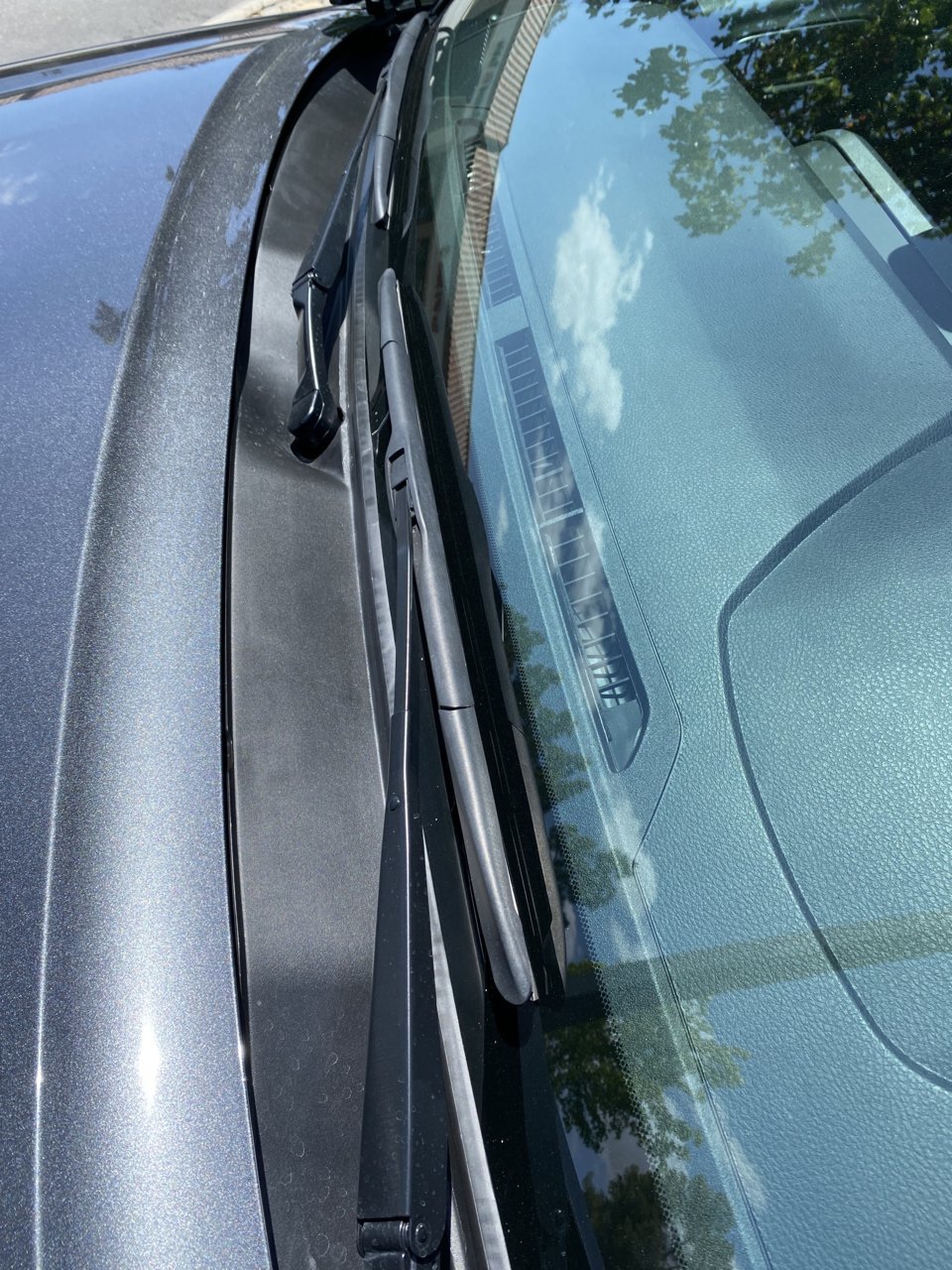

    There are a few threads however various answers.
    Is this not being sealing purely cosmetic or will it leak?
    Threads on TW have stated it will leak by the cabin air box, and some say its purely cosmetic. And there is an additional seal below that small gap.
    Furthermore what and how shall I and others with this issue seal it with?
    C804CEF6-9E71-467A-9999-71379DB79D8B.jpg 63E114E9-7225-4175-A6CA-109081B3A9FC.jpg

    It's not a seal, for water more for debris. Look at around wipers, it open. Leak come from drain under it becoming plugged by debris getting under cowl, and flowing over baffle around intake.

    As mentioned upthread, it's more for blocking debris than water. I've had mine off to install metal screen over my cabin air intake, for rodent protection. There's quite a bit of debris than can actually find it's way under this cowling. Especially if you live around trees.
    https://www.tacomaworld.com/threads/cabin-air-intake-screen-mod.566441/
    The visual gap that the OP posted in the center of his cowling against the glass is quite common.

    So that top layer not being seated doesn’t matter? Is there additional sealant below to prevent water flow directly into the cabin air filter intake?

    Yes, the bottom of the metal duct surrounding that cabin air filter opening has sealant. You can see it in the picture that I posted previously.
    The design of the plastic cowl does a good job at preventing water from directly entering the cabin air filter intake itself. Not saying that it could get water ingress if you purposely directed a hi pressure stream of water into the plastic cowling vents. My cabin air filter has never been wet. Small vegetative debris OTOH will swirl a bit and get into the intake. The screen I installed does a good job of keeping the large debris bits out of the filter.

    I recognize this is an old thread, but chiming in to state that I do in fact get leakage through my cabin air filter. Primarily when in a car wash. Had it happen once or twice in strong rain. And no blockages under the cowl, so that's not the reason. Need to tear apart to see if the weather stripping isn't sealing right, but this seems like a huge weakness. Heck, they put screw holes on that air intake, which makes me think at one point they designed a cover for it and ended up scrapping it when the trucks went into production. I've taken my truck to a dealer multiple times (under warranty) and showed them my sopping wet air filter, only for them to tell me there isn't a problem. Love my truck but this is beyond frustrating and now I need to arrange an AC repair because my blower motor is failing because it keeps getting wet

    @DiamBag I had this exact problem when i first got my Tacoma. It wasnt a new truck. But yeah, everytime a lot of water would run down my windshield like from a car wash or hard rain I'd get a puddle in my passenger floor below the AC box. I tested everything until i found water would run just right down my windshield, under the seal and right into the fresh air in the cowling in the above pictures.

    Yes. I took off that cowl piece, cleaned everything real well with window cleaner or Isopropyl Alcohol. Reassembled it with a fat bead of uv stable RTV and sent it. Over a year now and still going good.
