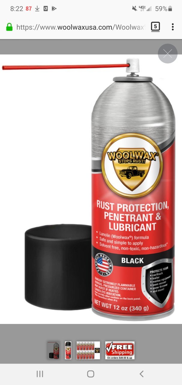

    Yup, I've heard good things about Woolmax too and the black option would look nice on the undercarriage.
    It sounds like Corrosion Free, Fluid Film, and Woolmax are all pretty similar.
