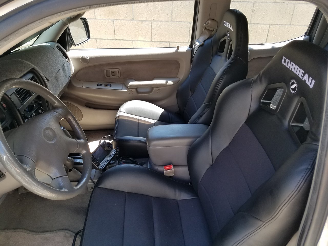

    Since seat swaps are a popular charge on the Tacomas, here is my seat swap.
    I purchased Corbeau Baja XRS seats with the double locking rail bracket. I very happy with these seats and the sturdiness on the brackets. I was disappointed with mounting hardware and lack of a hardware to mount the seat belt buckle. A trip to OSH which has an excellent hardware selection solved this problem.
    Here is the assembled bracket. I added the 3/4" spacers to give more room for an under seat amateur transceiver.
    The hardware I used here is 8mm-1.0 x 35mm bolts, 8mm-1.0 nuts and 3/4" spacers.

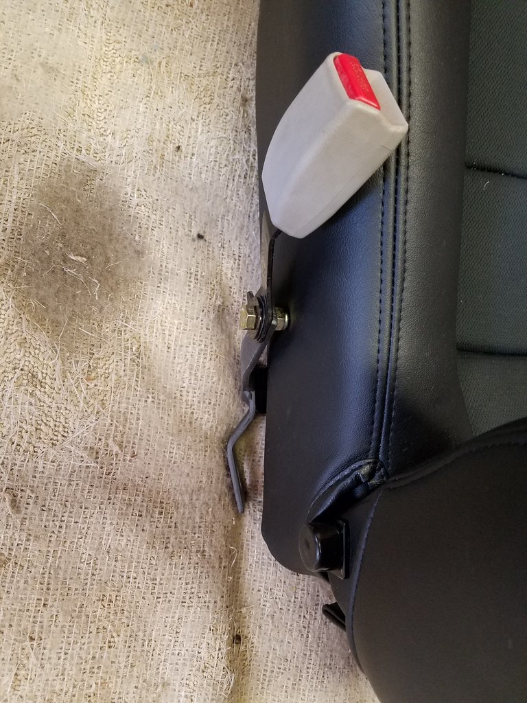

    This is how I mounted the seat belt buckle. I used a 7/16-20 x 1" grade 8 bolt, DIY stepped spaces, OEM wavy washer, nylon lock nut.
    The seats just fit but still can move for and aft and recline fully.
    The spacers are actually a benefit because the Baja XRS seats sit very low. The added 3/4" brought the seats up the stock height. The head room is now the same.

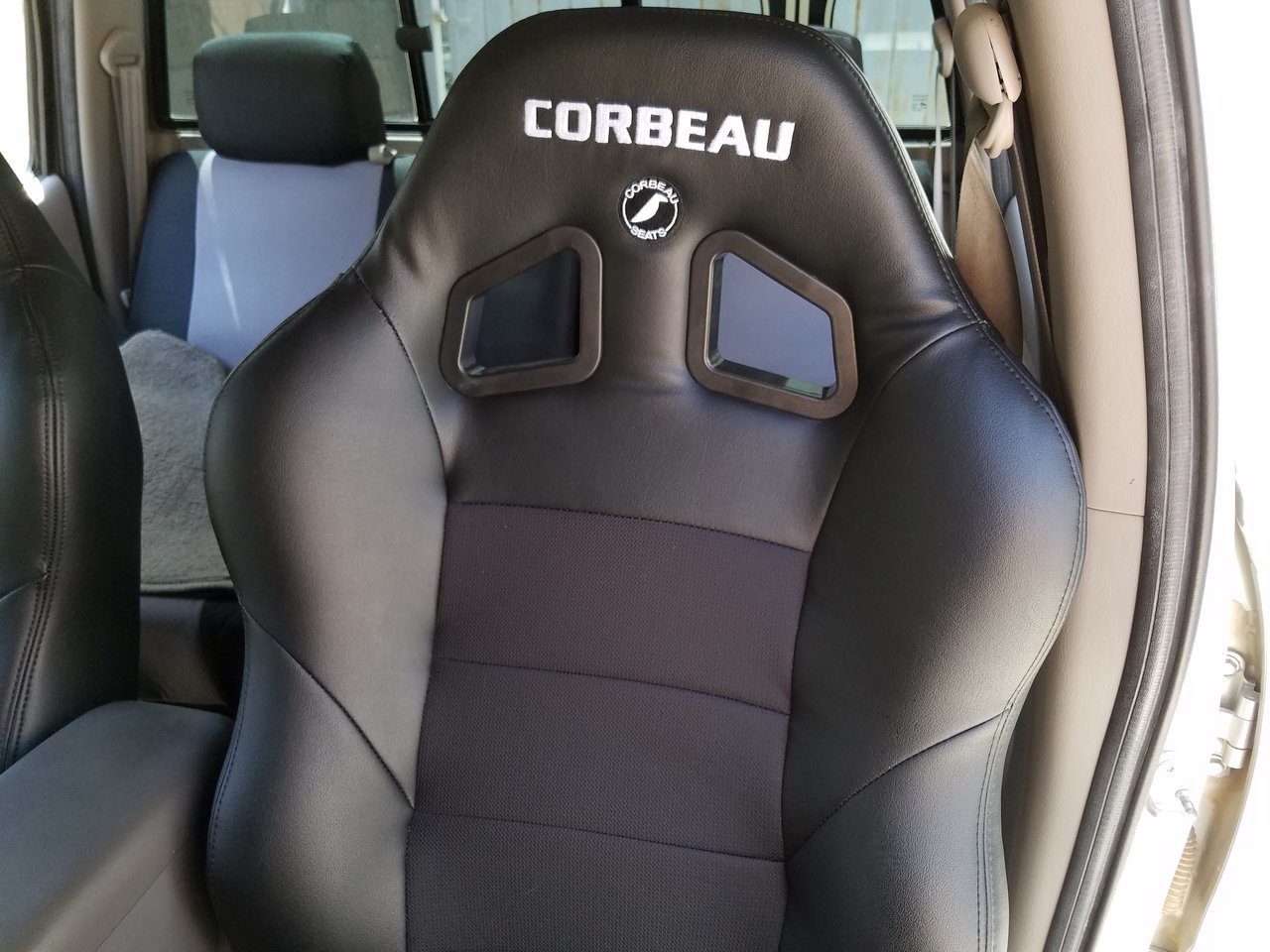

    The back rest has good lumbar support which is the reason I changed out the OEM seats. I wear size 38 pants and it is a little snug in the seat area. My butt cheeks are firmly squeezed together LoL. Hopefully as they break-in this will improve.
    I'm taking a long Sequoia OHV trip this weekend...I'll update on comfort later.

    I called there customer service and they said that black is the only available color. Too bad because black is hot and clashes with the interior. But function over form I always say.

    How are the sholder bolsters ? Do they make your shoulders roll forward?

    Overall I am pleased with the seats. There a little tight in the seat area because of the bolster. They seam to be tighter than the seat I 'test drove' at the shop.
    I like that the frame. It is rigid and doesn't flex to much. The bolster in the shoulder area is very nice. Being held into the seat on rocky trails that roll the truck back n forth is less tiring that holding against to the steering wheel.

    Did you make those stepped spaces for the seat belt?
