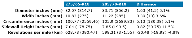

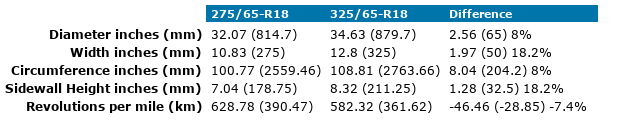

    I'm running an OME heavy duty 3" lift on the truck with an ARB front bumper. Currently I'm running 275/65/18 without any problems. I'm getting a free set of tires of my choosing and I want to know if I can run 325/65/18's.
    E.G. go from 32" to 34.6"
    I'm attached photos of my current tires for reference.
    from the online tire size calculator
    [​IMG][​IMG][​IMG][​IMG][​IMG]

    I doubt it with an ARB. Seems to be the consensus that the ARB is the least amennable to large tires of all the aftermarket front bumpers. There are a few guys running 35's on a 3" lift, but all have a non-arb plate bumper, and have cut their metal fenders to make them fit.

    I would just like to point out that a 285/70/18 is a 34", not a 33". I would stick with your decision to run a 275/70/18, as that is closer to a 33" even though that itself is still a little taller than a traditional 33".
