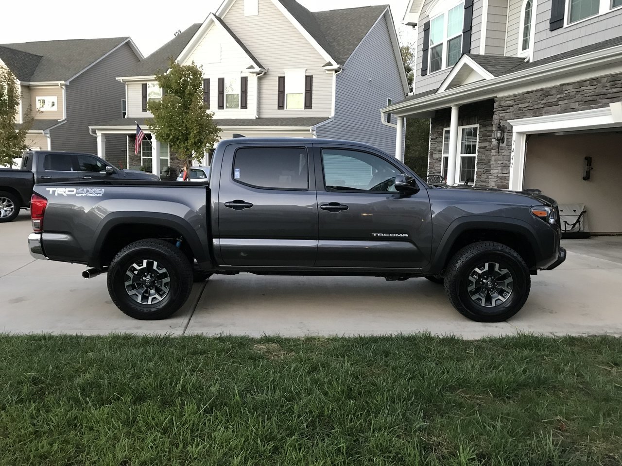

    FCAD2A7D-FECA-4B43-BC4A-704581AE021B.jpg I have a brand new 2017 Tacoma TRD Off-Road 4x4. What do I have to do in order to fit the Cooper 285/75/R16 on the truck. Will a 2” leveling kit work or does it need a 3” and block in the rear?
    Thanks in advance.

    I don’t mind spacers. I just want to know if a 2” spacer is enough or if I need to do a 3” spacer.

    I'm pretty sure he meant wheel spacer. 285's will rub on the uca's without spacer or a rim with less + offset.
