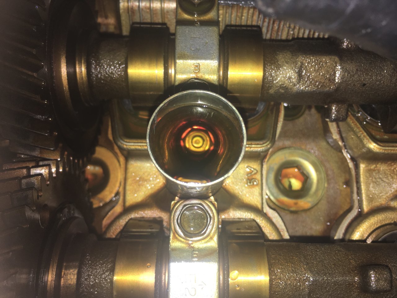

    let me add these to the story. Head gasket? Between #3 & #1. Closer to 3. Nope. Pretty much under 3. Weird though, I don’t have any head gasket symptoms.
    C3B999AE-65A1-4BA0-84B6-46B7D36E5A5A.jpg D7F3B6AB-A8EC-48AF-9910-DBA8B8435177.jpg

    Wondering if when I did the intake manifold gasket, if it moved when I put the cover on. If that could cause a leak from one port to another? & for some reason 3 was the weakest link? I did have the spark plug out of #1 & it didn't touch that.

    So if/when I take the cover off tomorrow, are there any signs that I should look for as to whether it's deeper than just the gasket? I doubt there are any tests I can do with it dismantled. Is a compression test advisable? Or we pretty much already know the results will be not so good.

    It makes zero sense that a leak filled up the plug well unless there is a coolant passage crack in the head and it is so close to the plug well that it is leaking into it when under pressure. I do not believe it would be a head gasket issue but more a head issue, possibly from a poor casting. I seriously doubt that coolant would fill the plug well if NOT under pressure.
    What I would do is leave the coil off that plug well, the plug in place, fill the cooling system, and pressurize the cooling system to it's normal pressure and then let it sit 1/2 hour and see if that plug well fills up, if so, you have a coolant passage leak in the head which will need replacement.

    Yep, this is a wierd one here......I would do a wet and dry compression test before you take anything apart......for shits and gigles if nothing else......
    Wonder if you can use a water hose w/rubber grommet and force water back the other way....
