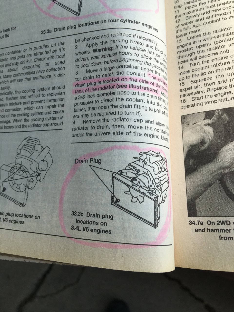

    I’m so glad you brought that up.
    The repair manual says it does but so far I haven’t been able to find it for the 3.4 5vz-fe motor. The “illustration” shows it somewhere by the power steering reservoir.
    Anyways, if I can find it, would I drain that after each water flush as well?

    On OLDER vehicles many times they were plugged and you needed a heavy wire or coat hanger (no hammer & chisel...) to bust through the sediment once the plug was removed. Once through you could remove a lot of sediment from the block through those drains. "After each flush", if it is easy to access and you are energetic and enthusiastic, why not...

    Do you happen to know the location of the drain plug on the 3.4L engine block? I've looked everywhere but I’m having trouble since I only have this crappy image for reference.

    To be honest I don't even know if there are any. I've just purchased my first V-6 Taco less than a year ago. My experience is with old American iron that had a drain plug on each side of the V block towards the center (front to back) just above where the pan bolted on... It looked like a standard threaded plug. I wouldn't be surprised if there aren't any. You know Toyota trying to save a nickel per unit.
