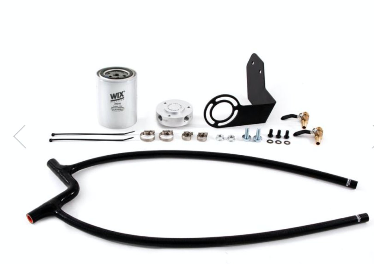

    Question: What coolant line is the best option to set up a bypass coolant filter on?
    It has been mentioned before on this forum, but turns into people telling the poster how it's a dumb idea, and not needed... Thats not what I am looking for. Yes it creates an extra spot for coolant to leak from, but if done correctly, it will not be an issue. The idea is not a revolutionary idea, it is common on diesel engines, as well as V6 gas Jeep systems.
    Yes, flushing often is a cheaper option, but I am looking for that extra step. This will be done along with frequent coolant refreshes.
    What I have learned so far:
    Bypass System is what I am looking to do. Its the safest option- Just in case the filter does get restricted, it will not restrict main coolant flow to engine. Something similar to this design in image below. (Mishimoto system sold for JKs).
    Filter selection- no additives. Most filters have additives that time release to promote longer coolant life. DO NOT USE FILTER ADDITIVES ON A GAS ENGINE SYSTEM. (filters without additives: (Baldwin B5134 or Wix 24070)

    Thats the thing, no manufactures currently make a kit for the 4.0 engine. So I would have to take that same idea/ part kit, but customize it to the Tacoma.

    As in, don't get that particular coolant filter kit? I was not planning on it. Image is only to get idea across of the set up and parts required.
