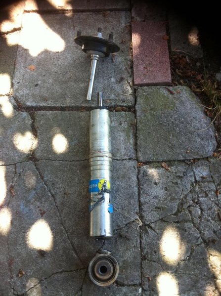

    If you add a spacer or leveling kit it puts a lot of pressure on the lower shock mount...usually resulting in this after an extended period of time:
    Did I convince you? :p
    Go with a coil over if you want to retain the stock ride as much as you can. You'll be happier you did in the long run even though it costs more up front. :thumbsup:

    Any shock can snap, with or without a spacer.
    The ONLY time a spacer will "put a lot of pressure on the lower shock mount" is if you use too big of a spacer and bottom out REALLY hard(jumping or hard wheeling). If you space the bump stop down you completely eliminate any chance of bottoming out the shock.
