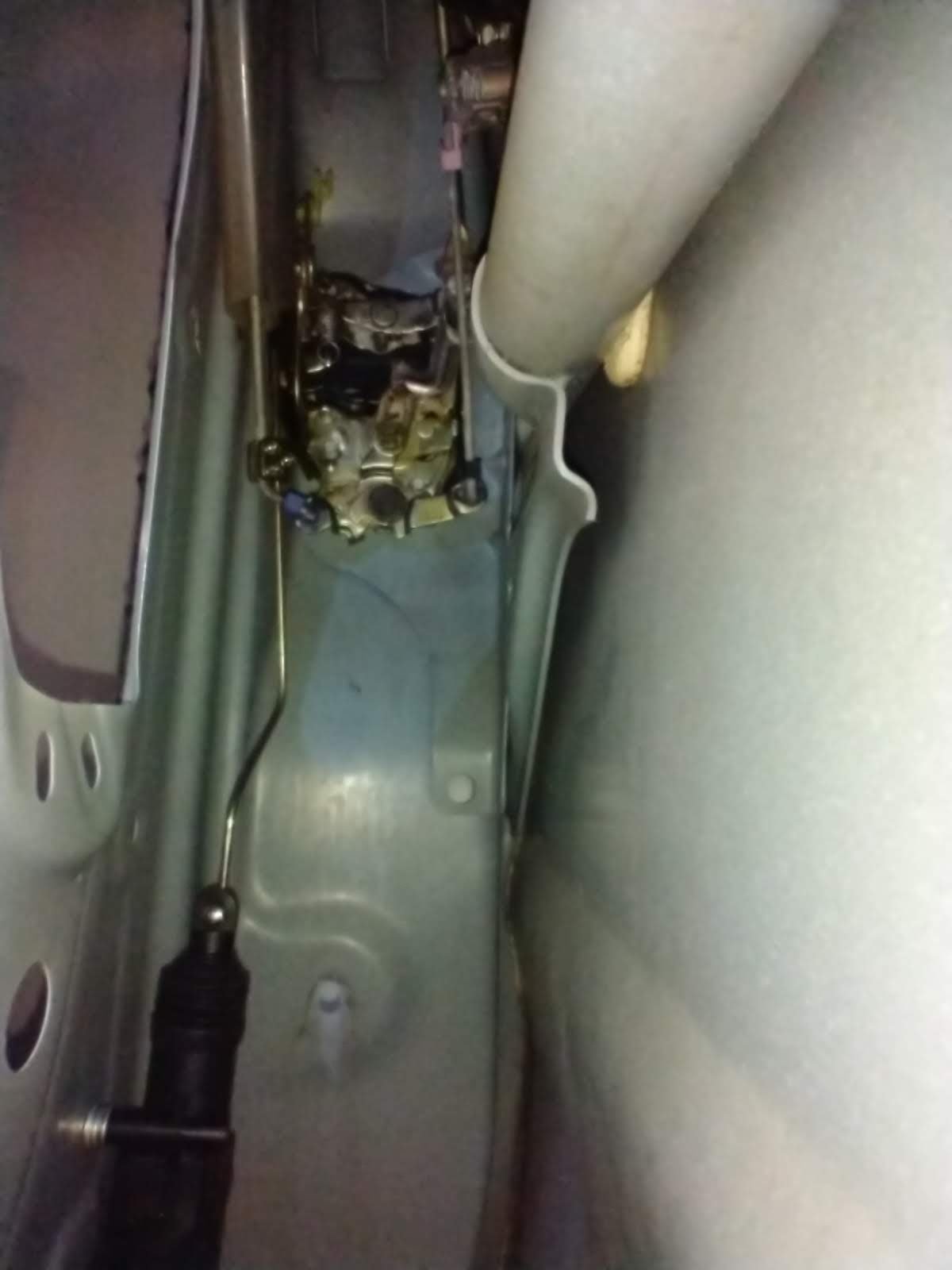

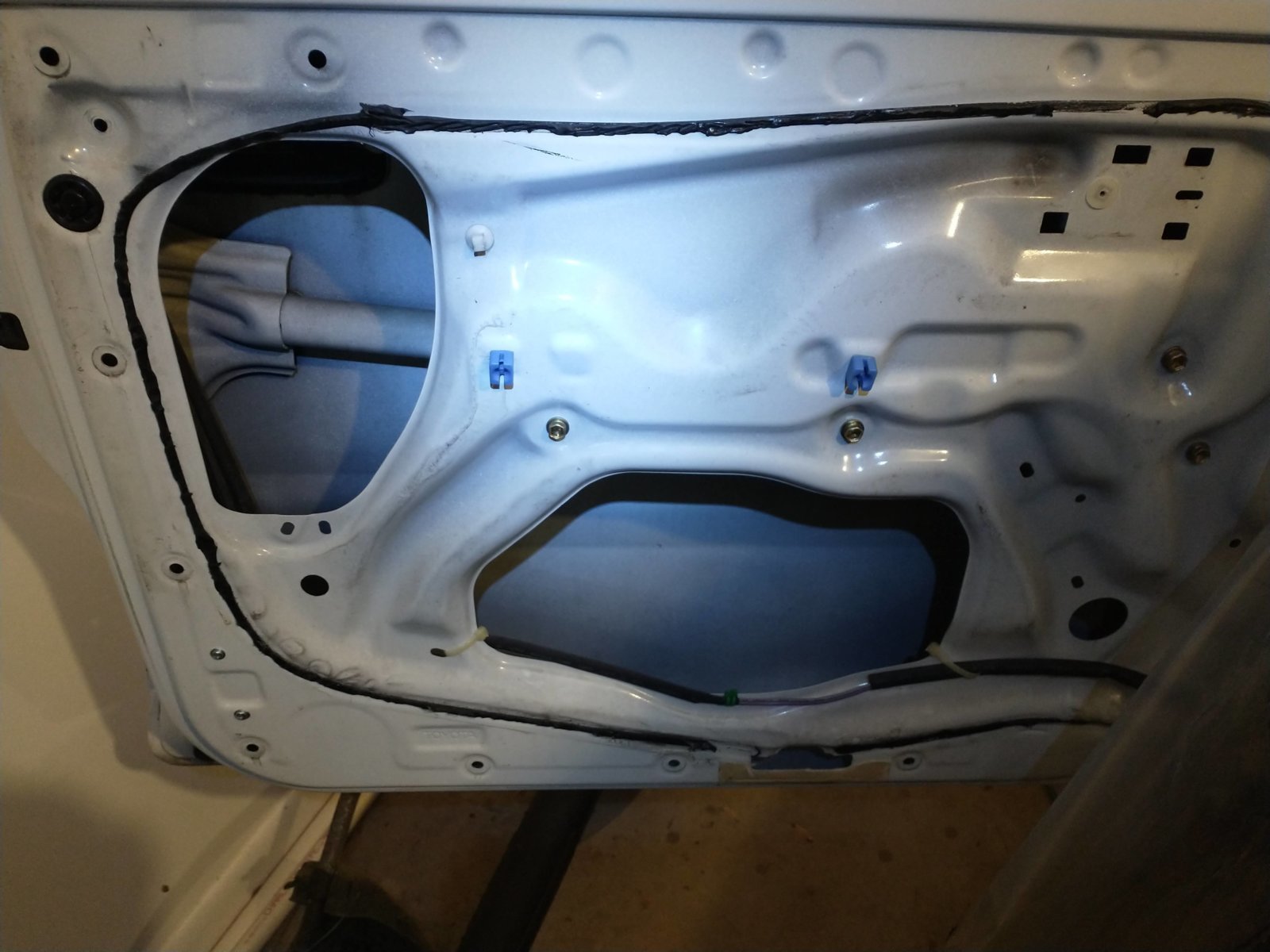

    I acquired a 96 Tacoma that is in excellent condition a couple of years ago. Great truck but not having power windows and locks was a nuisance. Especially when people were asking to buy the truck at a stoplight. I decided to convert to power but was unable to find much help online that met my requirements.
    1. Total cost less than $150.
    2. Keyless entry.
    3. Must look stock.
    4. Minimally invasive.
    5. Easily reversed. (In case things didn't work out)
    After hours of research, I ordered the parts I thought I would need. It took a total of four days for the installation. A day and a half was spent on finding a location for the aftermarket door lock actuator. There are quite a few variables inside the door that I did not anticipate. If anyone is interested, I can provide a list of items I purchased and a template for where to install the actuator. It has been two months and no issues.

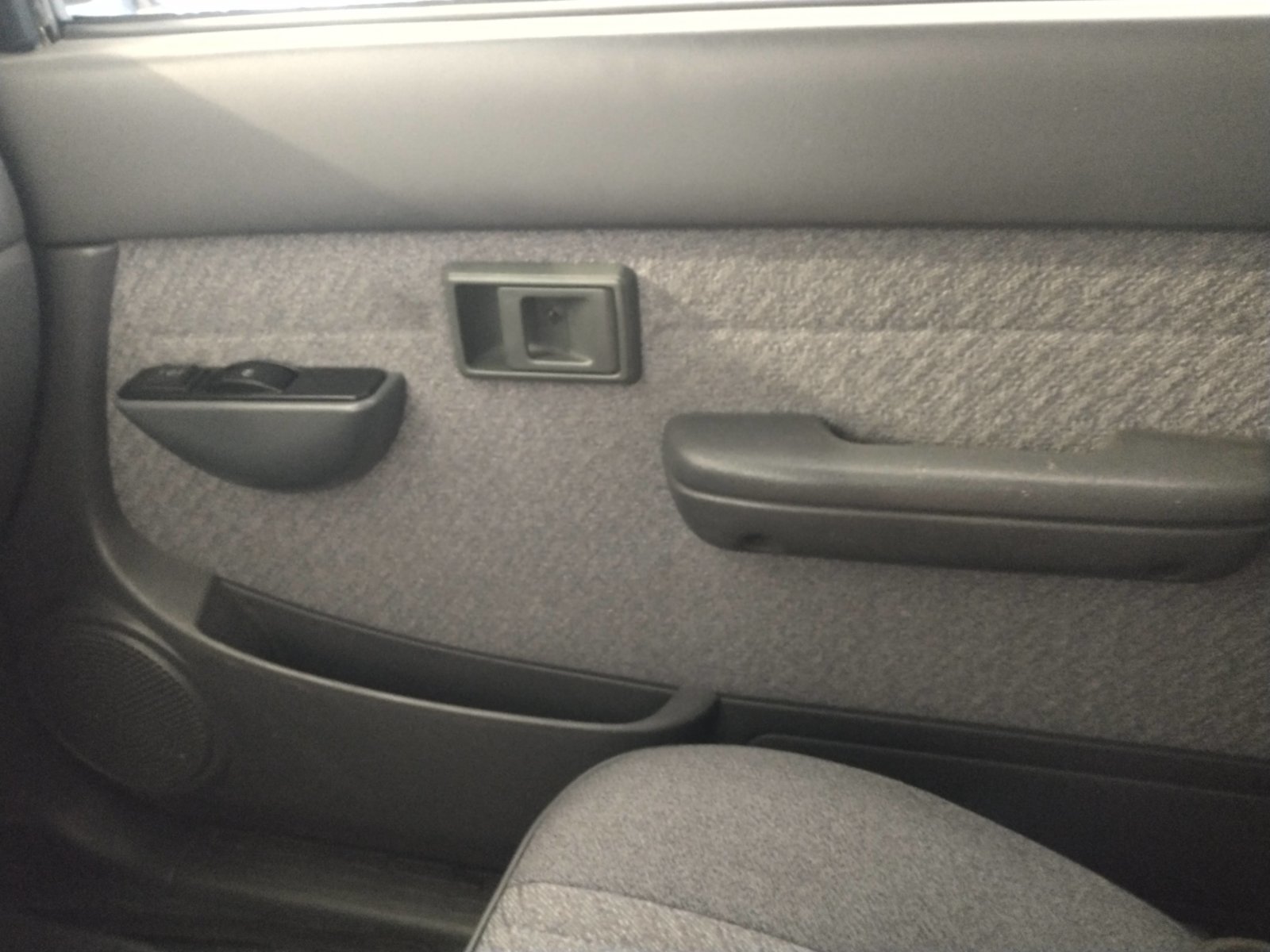

    Addition parts I used to add door lock switches so I would not have to manually lock/unlock or use the remote while in the car

    Fatal_Paradox - I am not sure what the differences are between my 96 and your 01. All of the parts would probably be the same but the location of the door lock actuator may have to change. Finding a location for the actuator was the biggest pain of the entire project.

    DELL648. Where do you buy a Power Door Lock & Power Window combos handle (1st image & 1st post). I just bought a 2003 toyota tacoma 2.4L manual doors & windows and would like to convert to power.

    mY13ToySalvagedTruck - I installed the door lock switch into the power window handle. It did not come that way. On the driver's side, I installed the door lock switch in a vacant switch position on the dash.

    Thanks for drill templates, great work!
