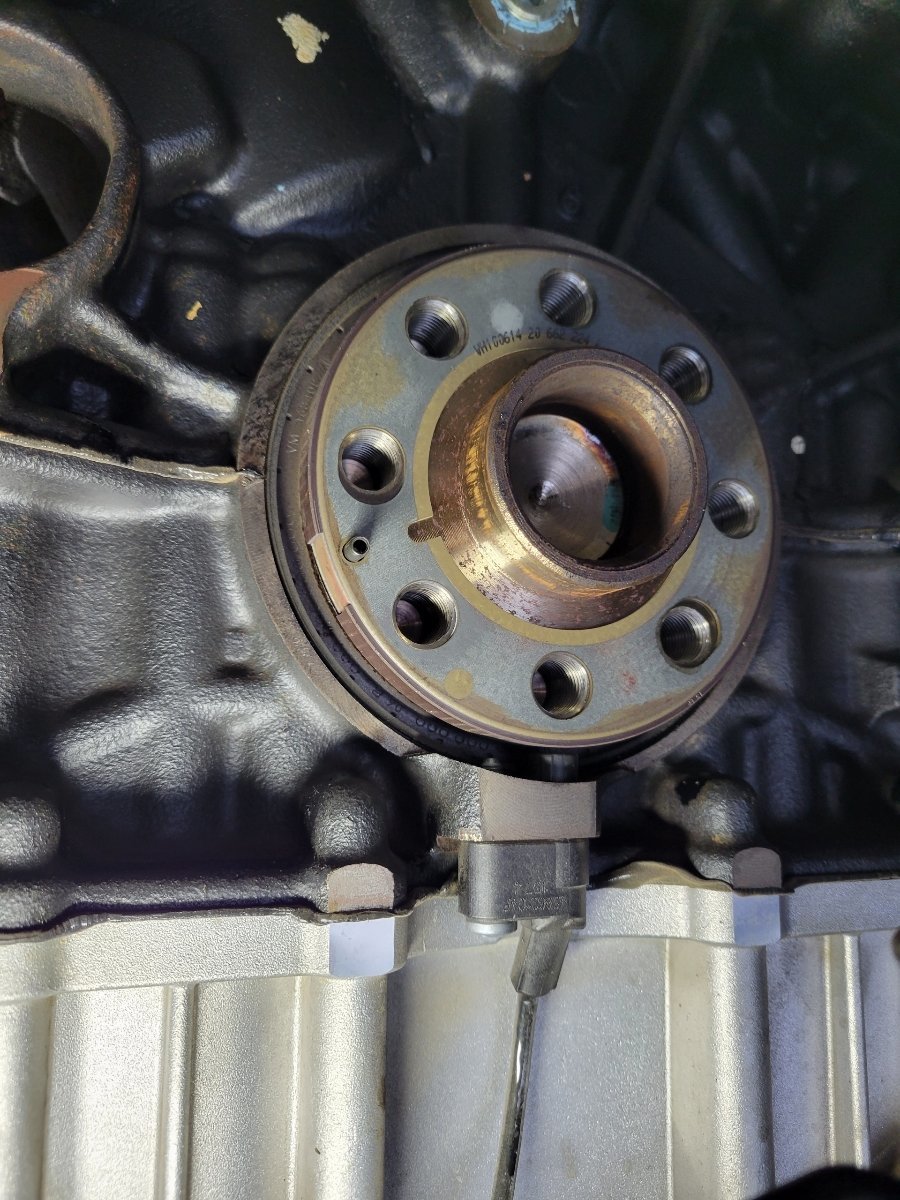

    Here's an example of why not to buy a Dodge. 2015 Ram 1500 with the small EcoDiesel V6. Crankshaft sensor reluctor ring delaminates and falls off the crank, resulting in a stall, extended crank time and CKP codes.
    The shit is basically glued on like tape weights on a wheel. Dodge's recall fix? Bring the vehicle in and they will flash the software to ignore the crankshaft sensor and go off cam sensor only so it won't stall. No updated parts, no campaign to replace the faulty parts.
    Transmission and flexplate have to be removed, it's a 6.5 hour job
