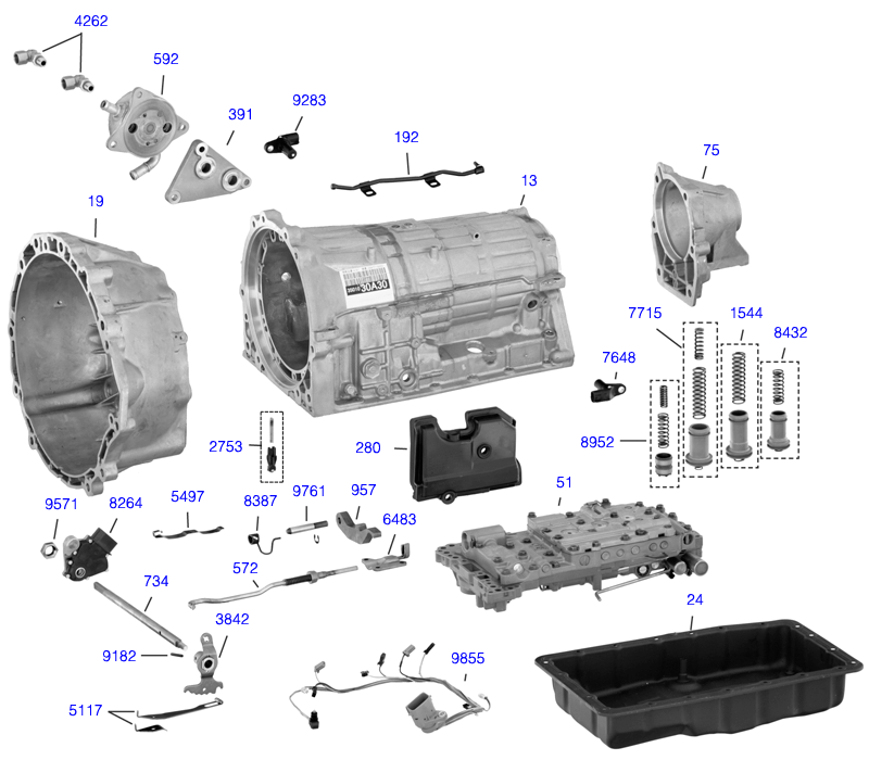

    Hey all, I am wondering more about the differences between these two transmissions and if anyone has information on the plugs and what they technically do.
    From what I Can see they are nearly identical and wondering if this might be an upgrade for people running an a750f transmission.
    Does anyone have access to both and can take some detailed full res photos to share?
    I did see that a lot of shared parts including gears 1 through 5 are all identical and the a760f gets a second overdrive gear and one more lockup.
    a760f (image looks to be of an a760e but labeled as a760f)
    a750f
