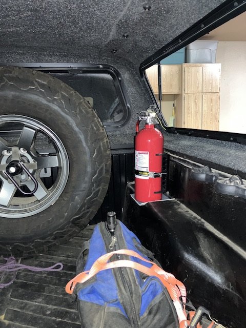

    Here is where I have one in my tacoma, don't have pics of other cars locations. And yeah I've used one before. 4th of July watched a guy light the side of his garage on fire with fireworks and a bbq.

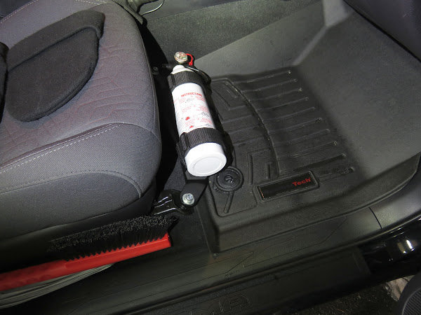

    I keep a 2.5 lb 1A10BC on a Refined Cycle P/N FM2-K25a mount using the front passenger seat bolts:
    AJFCJaUUm8aRCkkdpgdTnveYhOHId53xS6ZFULuP_af563fa03f0fc815caf17cc54ae6bd8f21017a92.jpg
    For wheeling/camping trips I bring a second 2.5 lb 1A10BC extinguisher in the gear bin (together with a booster pack, first-aid kit, tire plug kit, duct tape, zipties, fluids...)

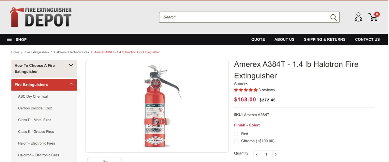

    I am looking at non-conductive extinguishers like PKP (Purple K) and Halotron to carry with me in the Taco and the classic cars. Do any of you have experience with the Halotrons? My local safety store recommended them since Halon is no longer available except in high end, permanent race applications. Halotron is damn expensive and I don't know what, if anything is better than a PKP.
    Any thoughts from those of you who run extinguishers?

    I don't think a Class C (electrical) only nonconductive extinguisher agent is necessary or appropriate for automotive use. There are many far less expensive BC options and the Class B component is for oil, grease, and fuel which IMO is necessary for automotive use. I stay away from ABC because the A components can ruin any electrical and electronic components you save from the fire. Plus it's hard to clean up.
