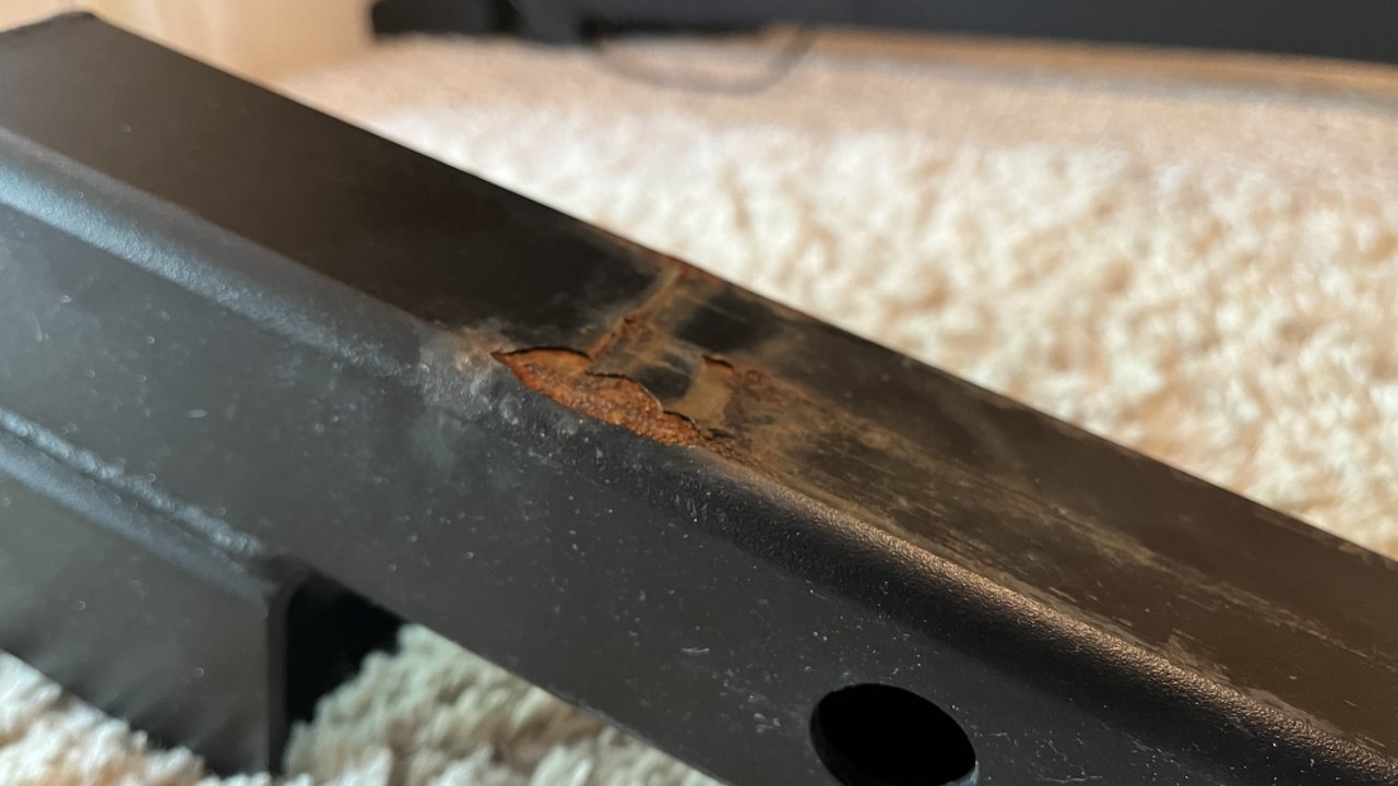

    I use this Kuat extender in my receiver for my bike rack, so that I can put my tailgate down without it hitting anything. It's been in there for almost a year. Recently replaced my rack, and noticed that the receiver was rusting inside (coating was worn through) and this extender is rusting. IMG_0542.jpg IMG_0541.jpg
    Any way to clean this up and prevent it from rusting even further?

    Wire brush and a can of Krylon.

    I sand and repaint my hitch every year before winter. If you use it at all, the paint will get worn off.

    Spray Cosmoline in the hitch receiver tube.
    Put a rubber plug (like the OEM plug) on the front end of the receiver tube (facing the spare tire) if you have room.

    Clean it up. Scrape all loose paint/powder coating off. Use a self-etching primer followed by a quality top coat.
    Repeat annually as needed.

    Rust Check undercoat spray in the green can is my favourite thing for this. I was turned onto it by my John Deere dealer and anywhere I see rust on my tractor or implements it gets greased. I do the same with trailer stuff. I'd knock the loose paint off that hitch and grease it. Done.
