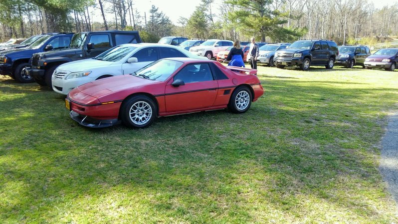

    picked her up on a warm fall day with the wife and dog
    a little fuzzy. car was extremely well kept

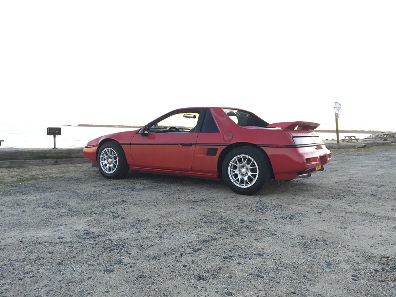

    Final product vs stock. will yield roughly 1'' lower than stock.
