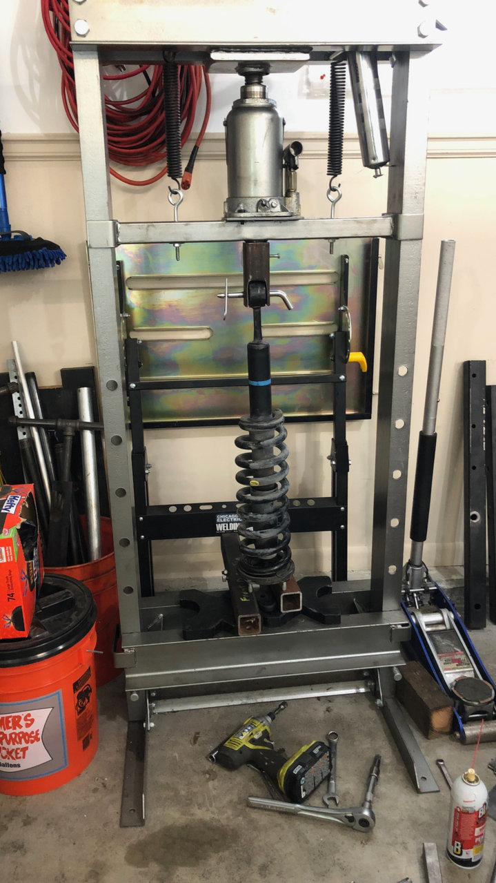

    I’ve used my shop press numerous times for compressing the coilovers and separating the top plate. C3D87530-75D6-4C71-9632-98C2CC066276.jpg 57115E0B-F9B2-41F1-990B-010FD4698FF6.jpg
