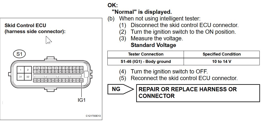

    DTCC1241/41 Low Battery Positive Voltage
    DTC Detecting Conditions
    DESCRIPTION
    If there is a problem with the brake actuator (skid control ECU) power supply circuit, the skid control ECU outputs a DTC and prohibits operation under the fail safe function.If the voltage supplied to the IG1 terminal is not within the DTC detection threshold due to malfunctions in parts such as the battery or alternator circuit, this DTC is stored.
    • At vehicle speed of 2 mph (3 km/h) or more, voltage at IG1 terminal remains at 9.5 V or less for 10 seconds or more.
    • When solenoid relay ON, voltage at IG1 terminal 0.5 V or less, and contact of relay OFF for 0.2 seconds or more.
    • When voltage at IG1 terminal 9.5 V or less, voltage of speed sensor power supply decreases for 60 seconds or more.
    Trouble Area:
    •Battery
    •Charging system
    •Power source circuit
    Check the IG1 NO. 2 fuse. Less than 1 Ohm.
