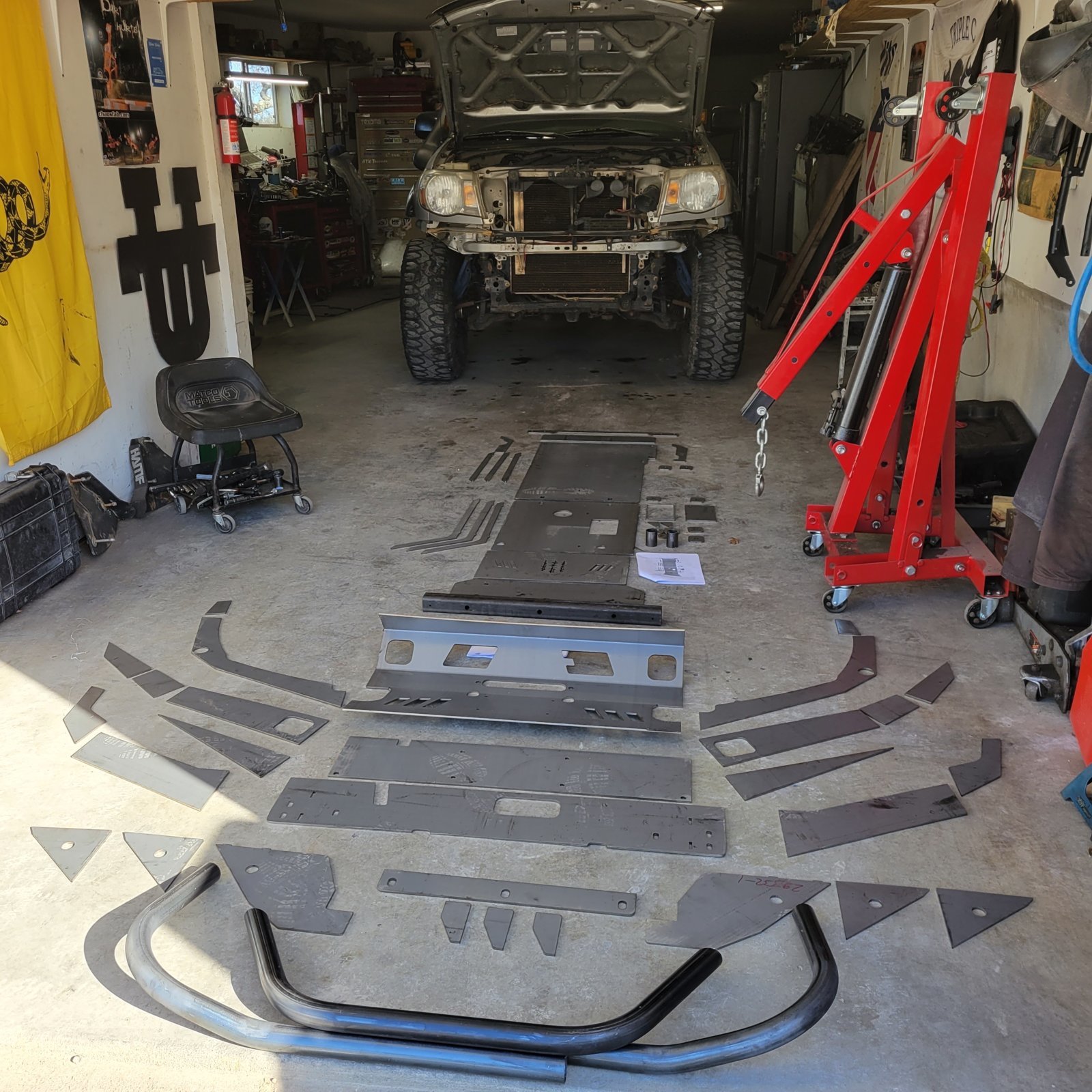

    Sup tw. I haven’t seen a write up or videos about this specific bumper so thought I would make one. This is the extreme clearance front bumper made by coastal off road for 3rd gen tacomas.
    Boy did this whole thing drag on.. So I’ll preface by saying they sent me the wrong piece and customer service was a little iffy getting it to me in an appropriate time frame but nonetheless I received the right part. Instructions that they sent to me were a mixture between 2nd and 3rd gen so it was a little confusing but they did the job.
    Buyer beware that this bumper required a bit of custom work not included in the directions. Power steering cooler lines needed to be relocated quite far from the original spot. Once I add a winch I will have to figure what I want to do with them bc they probably won’t fit where they are. Maybe they will well see.
