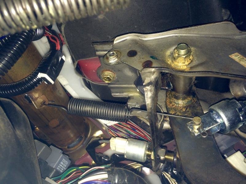

    Hello, I have a 2003 Tacoma 5 speed. I just installed a new clutch, but even before I installed the clutch the pedal would not return all the way. I have to pull it back with my foot about a quarter inch every time I shift. I cannot find a spring anywhere I believe that that is the issue

    When I boght my truck, the clutch petal was not returning all the way but I did not know it. I had nothing to reference it to. Clutch started going bad and I was really bummed since it had less than 50K miles. One day when I was releasing my foot off the clutch felt a pop when the clutch came up an additional distance and made contact with my foot. Then I started having to pull i up the rest of the way with my foot.
    Finally I had the clutch replaced, with a new master and slave cylinder all from Marlin crawler.
    Its still doing it. So next I will do the spring

    Sorry to say you probably wasted your money on that master and slave cylinder. I can almost guarentee it's your return spring. I bet your cruise control doesn't work or works intermittently as well.
