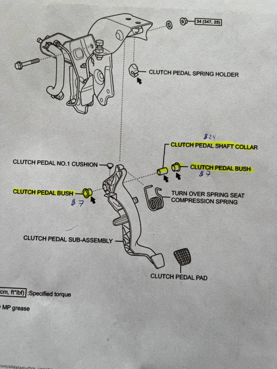

    I did noticed it seemed the clutch pedal subassembly had some possible excessive play at its pivot bolt and suspected the pedal bushings were possible worn causing the clutch pedal sub-assembly to possibly bind and hang up. I removed the pedal sub-assembly and the bushings seem fine. I am wondering if it is possible the slot where the torsion spring slides in the plastic pedal sub-assembly (why plastic???) is worn abnormally and causing the torsion spring to hang-up and not slide efficiently when pedal fully deflected to the floor.
    Attached is picture of the pedal sub-assembly slot where the torsion spring interfaces. Can anyone confirm if the slot looks normal or not? Anyone else have similar issues?

    I just replaced those parts you circled as part of also replacing the master cylinder. My pedal had the slop you talk of and those parts took out most of the play.......at least as tested on the bench, as I have not installed the assembly back in the truck.
    Take a careful look a the clutch turnover spring at the top of the pedal and its holder. I noticed that without the hydraulics connected the pedal will go to the floor and stay there.

    As far a the notch you show on the pedal I am going to replace the cruise control cancel switch on the mounting bracket this morning and will check to see if the spring rides in the top of that "V" or in the bottom.

    OK, so I got the clutch pedal support assembly mounted. The top of the clutch pedal looks just like yours in the pic and the tab of the turnover spring sits in the bottom of the saddle.
    The hydraulics have not yet been connected. With the pedal at rest in the up position if I push it down about a third of the way and let go it will return upward to its rest position. But if pressed down to about half way or more it will go to the floor and stay there. I'll report back more as it goes together.

    This is normal pedal action due to the action of the torsion spring after it is past halfway to the floor. The torsion spring "toggles" force direction in the opposition direction (i.e. towards the floor) pasted the halfway point. Watch the torsion spring relative to the pedal attachment point as you deflect the pedal - you will see what I am saying. I noticed the same thing with mine and thought is was a little confusing at first but it actually makes sense now. It appears Toyota designed the torsion spring action to assist in disengaging the clutch beyond half pedal deflection. The master cylinder will counter action this downward deflection force caused by the clutch pedal torsion spring by the back pressure provided by the clutch pressure plate fingers (through the release bearing, release fork, slave cylinder and fluid up to the master cylinder).
    It can make things a little difficult to diagnosis issues without appreciating the counter intuitive pedal response caused by the pedal torsion spring action.
