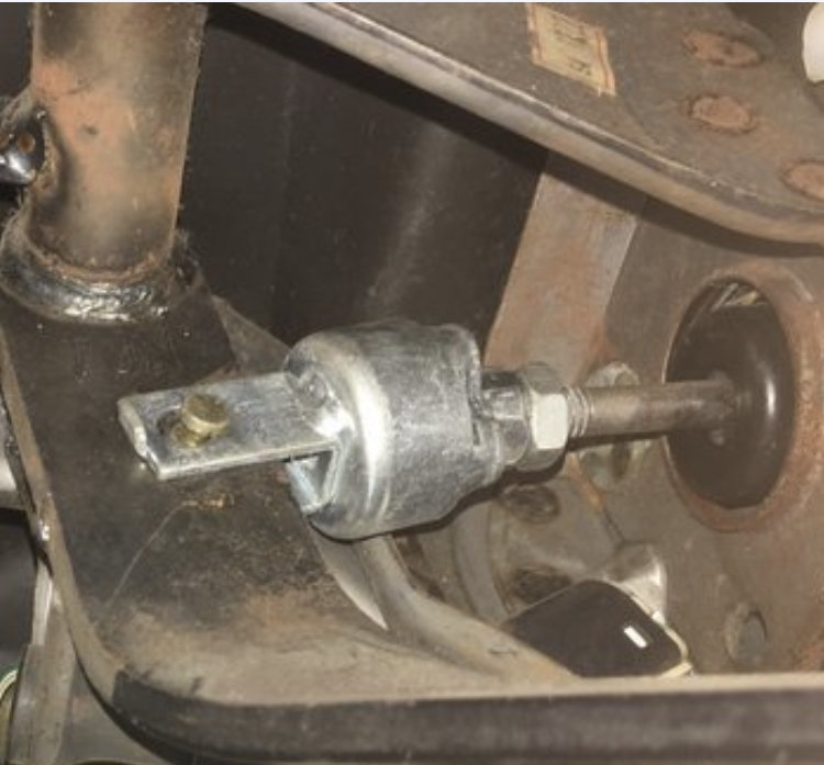

    Take a look at the mechanism and mounting points of clutch and spring under dash. Support brackets or spring mount may be loose/broken and the rod fork is known to break as well. The fork on transmission can bend, crack and break so look at it while pushing clutch.47162A11-FB3F-45E0-9565-298B3252F351.jpg

    Well, I replaced the Slave to no avail-the pedal still goes to the floor. I did notice that some sort of plastic ring that goes around the rod that connects to the pedal is broken and that mechanism doesn't seem sound. I've attached a couple of pictures for reference. Would I replace that silver thingy?

    I wasn't able to find a replacement adjustable fork without buying the Master cylinder it comes with so I welded up my own and used the OE rod and nuts.
    I have no idea why that plastic design was used but it fails.
