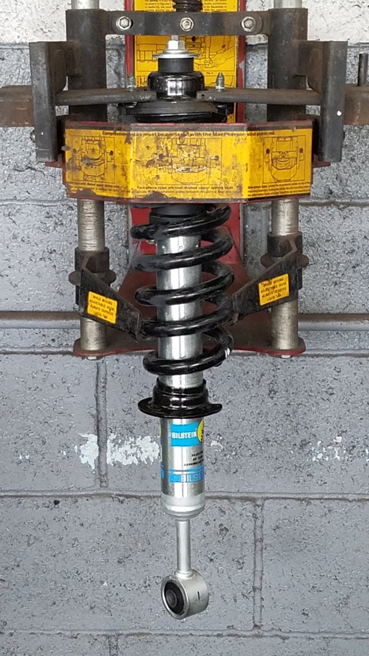

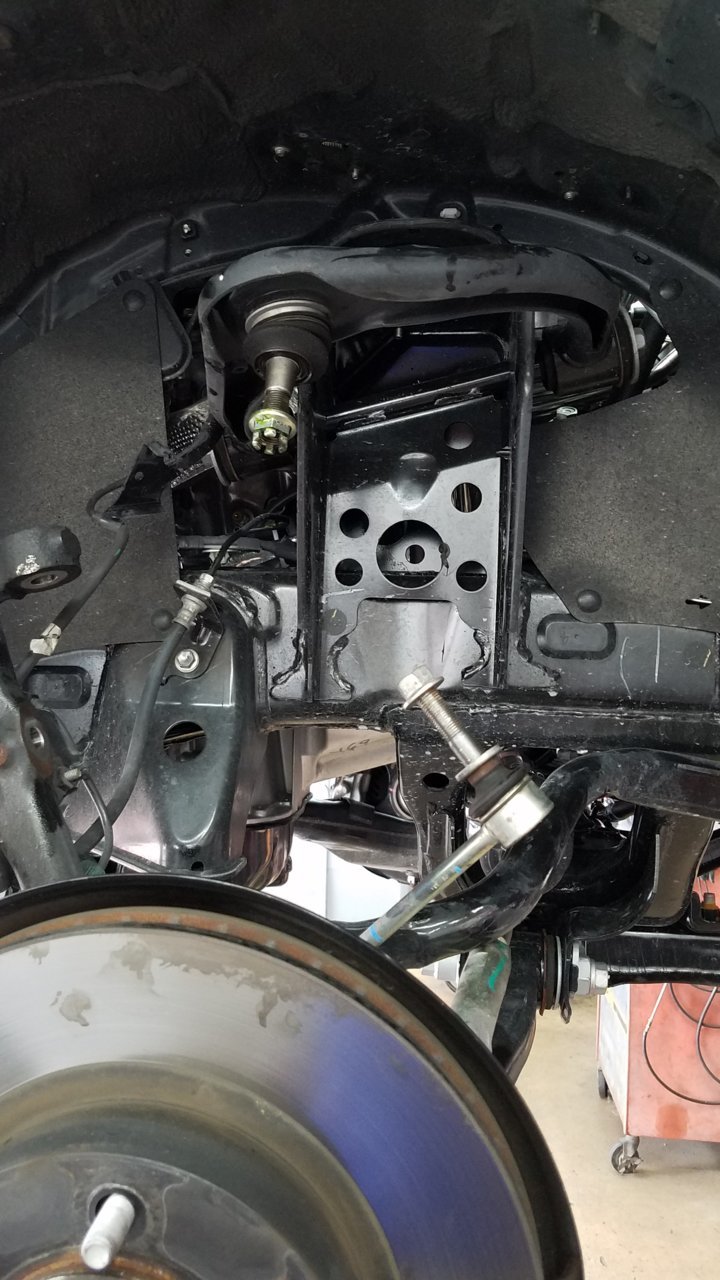

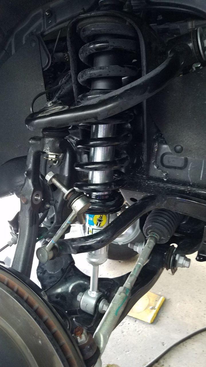

    Actually, I had my front OEM struts replaced twice at the dealership within 7,500 miles! Both sets began making that metal snapping noise within 1,500 miles of replacement. The noise only happened when the strut assemblies were completely compressed or completely extended, like going over speed humps or off road. I replaced the front OEM's with Bilstein 5100 struts. I can't say the truck drives differently, but that snapping noise is gone.
    I brought the 5100's on Ebay with a 15% off coupon. I paid something like $177.00 for the pair.
