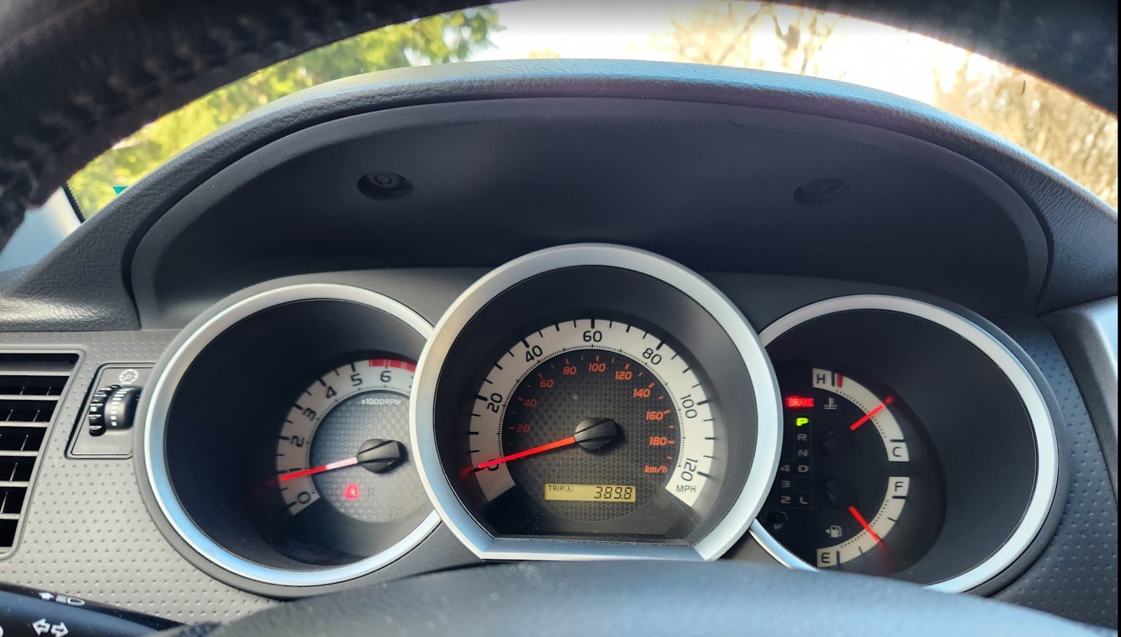

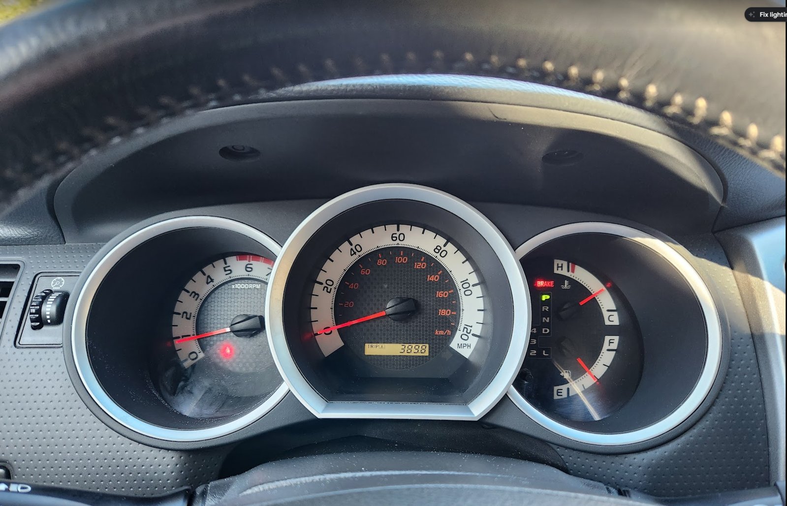

    Finally got around to it. I used lens wipes (basically eyeglasses or photolens super fine microfiber wipes) as the applicator, and applied almost ZERO pressure and just let the PlastX do the work. It didn't get it to absolutely perfect, but man it cleared up the cloudy/haze. I was a dumb and didn't take full Before pictures, but here's a mid and after shot.
    Center speedo was honestly worse than the tach and fuel/temp but I was too excited and didn't take a pic of it before. You can see there's still a small dot on the speedo by the 40/60/80 KPH that I ALMOST got out completely by the end. Picture the whole speedo like that dot down to the Trip. It was gnarly.
    Not perfect, but I can deal with that for a soon to be 12 year old truck. I think it got them down to the level of microscratching and hazing that those overlays mentioned above would work, if I ever go down that route.
