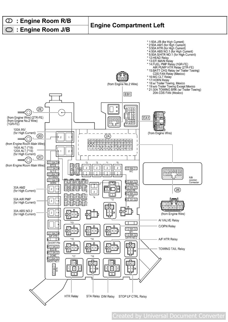

    As others have said being there was an airbag deployment the Airbag module is likely the cause of the light but have you checked the rest of the horn circuit?
    Not much to checking it as it's a very simple circuit.
