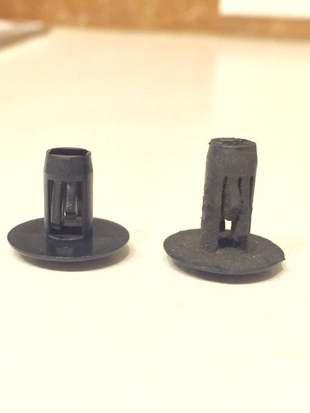

  5. Sep 14, 2016 at 6:34 PM
    ThunderOne
    ThunderOne Well-Known Member
    May 20, 2009
    #17473
    10,042
    Mitchell
    Nashville
    1ST GEN OR GTFO
    Toyota NERD
    eBay clips on left, OEM on right
    Colchicine likes this.

    Finally ordered the Toyota part for it. After much confusion the correct part number for these clips is 90467-10173. Hold much better than the eBay ones

    They're for the black plastic inner fender not the actual rubber aprons that hang around upper control arms.
    you want these:
    Part Number: 90467-10173
    • Part: Seal Retainer
