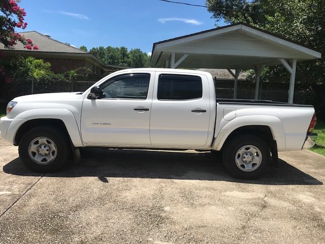

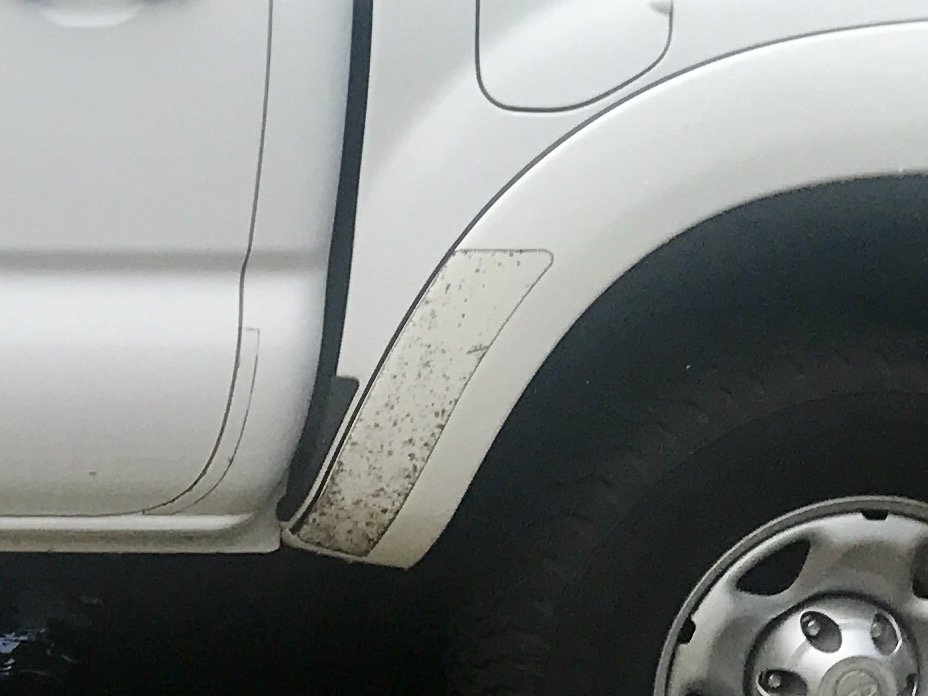

    I know this thread is older but maybe you guys will still see it. I have a 2006 Tacoma with that stupid film on the rear fender flares and right behind the driver door. I am doing some long needed upgrades so I can keep my truck for 10 more years and really want those nasty things off. My concern is they have black not only around the edges but spotted throughout the piece. Do you think they will come off clean with the above suggestions or have they been on for so long I will end up with a paint issue? I really like the plastidip above. Curious on your cost for that?

    They will come off using the above procedures. The paint may be just a bit darker under the film after that length of time but likely not very noticeable. Not nearly as noticeable if at all, than the spotted film. My suggestion is to remove the old film and replace them with new. It looks like they have certainly done their job protecting that area of your paint. The dealer should still be able to get the film pre-cut or you can go on Ebay and buy 3-M Paint protection film. Best bet if your not familiar with applying this film is to bring them to an accredited body shop for installation or you can search your area for Scotchcal paint protection film install centers. I replace mine every couple of years as needed. My newer 2015 Tacoma has had one side replaced already as I live ongravel roads. Inexpensive to replace...

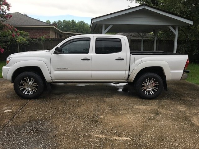

    Thanks for the info! I just completed my first of a few upgrades I plan to do to my truck so I can keep it for many more years. I love it too much to get rid of it. Plus, I haven't even broken 100,000 on it yet.Tacoma before.jpg Tacoma after wheels and tires.jpg

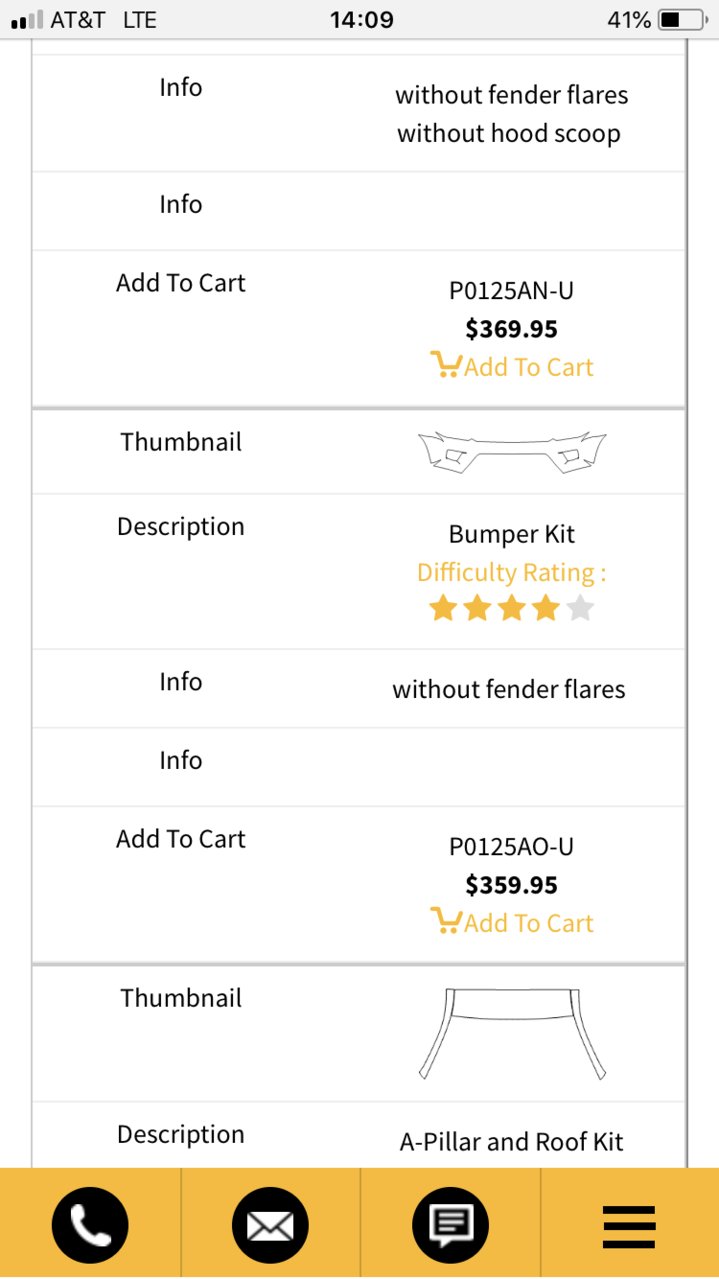

    Can any of y'all find a link for a custom fit chip guard decal?

    I would love something like that as well. Anything out there that is under $400-500?
